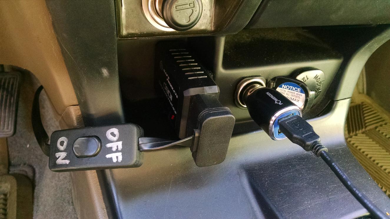

Along with the reader, I highly suggest getting this OBDII extension with shut off switch so you don't have to pull your reader out every time. The reader will continue to pull a power draw even with the ignition off so if you let it sit long enough, it could drain your battery.
https://www.amazon.com/gp/product/B00UR5XBMW/ref=oh_aui_detailpage_o08_s00?ie=UTF8&psc=1

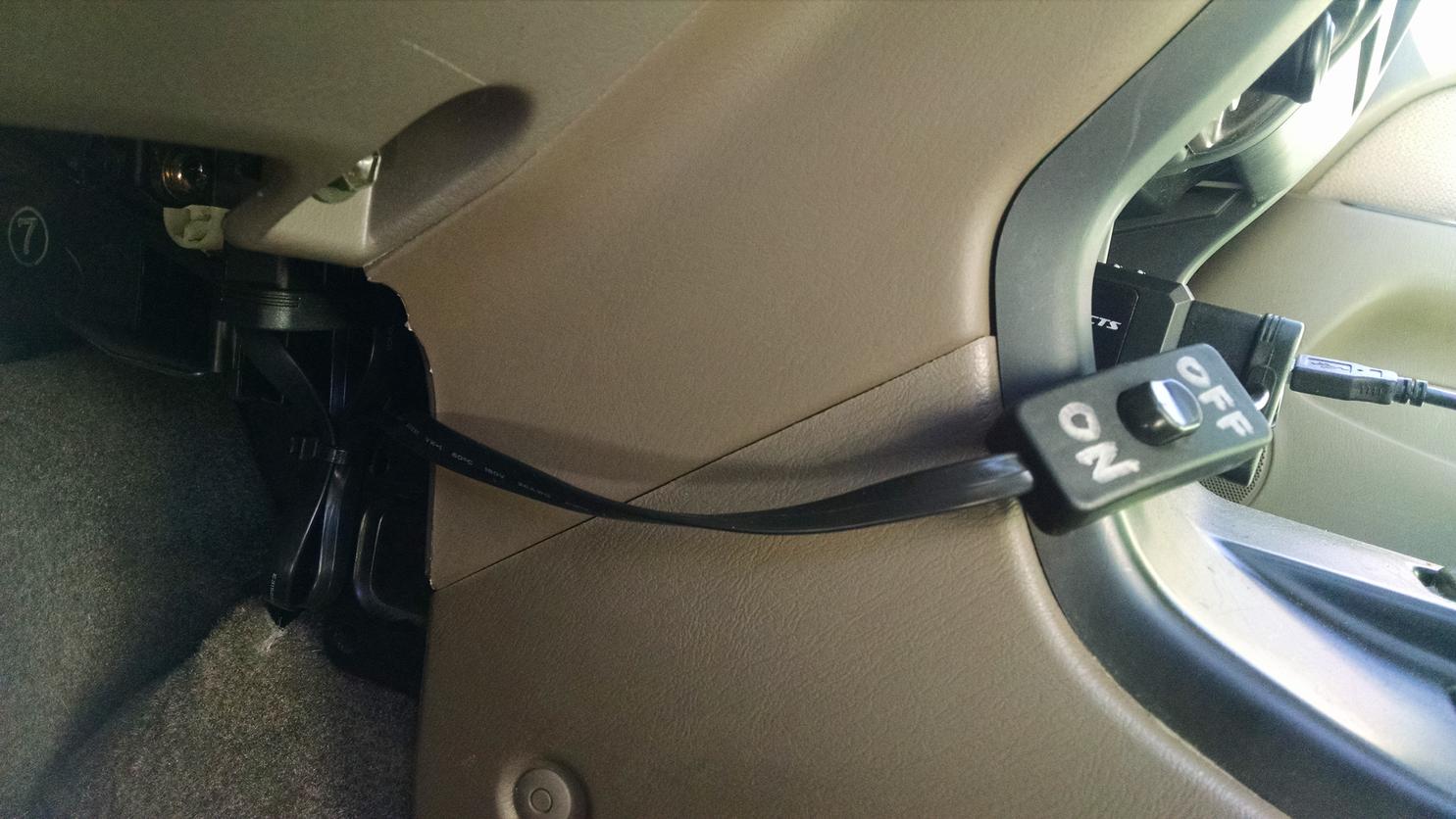

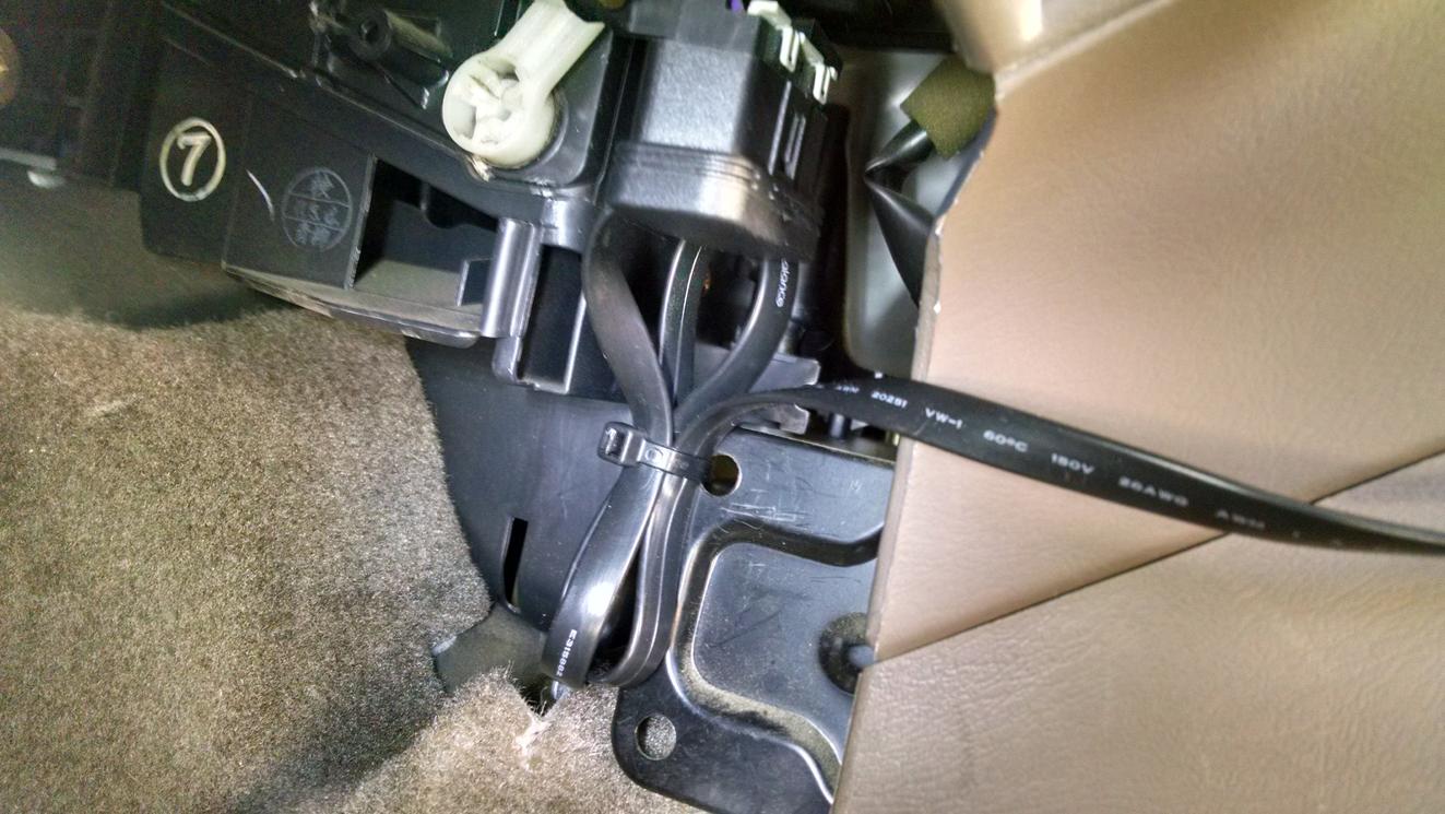

I used velcro to affix the reader in the bottom tray under the cigarette lighter and ziptied the extra cable under the dash. I also wrote "on and off" with a sharpie. Other than the benefit of being able to keep the reader connected without worrying about draining the battery, I like that the reader is no longer near my right foot when I'm using the accelerator pedal. I've accidentally bumped it a few times with my foot but not hard enough to break anything. Now that it's out of the way, I don't have to worry about that either anymore. A final benefit is because the OBDII port faces downward, gravity is working against you. On a bumpy fire road, my reader actually fell out but I no longer have this issue anymore.
