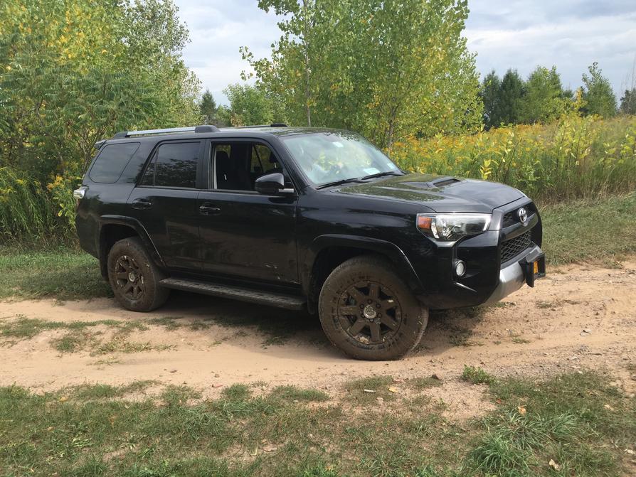

I've done serious off-roading with my stock tires. I conquered every challenge at Rausch creek when I went with all lifted Jeeps. I had little tires slip and only had to lock my rear diff once and I really actually don't think I needed the extra help. My stock trail is a beast.
