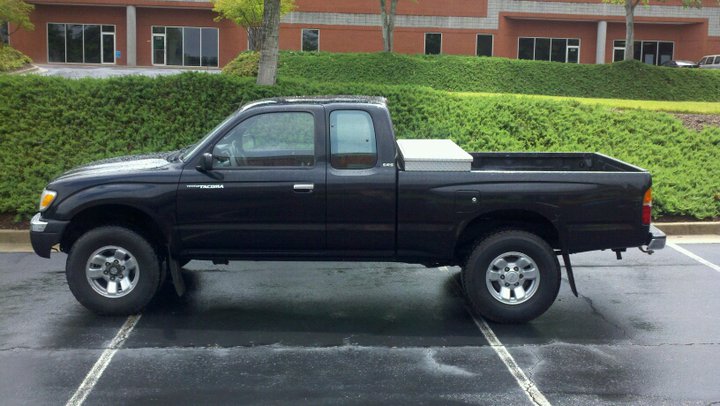

I've had my 98 4Runner for 2 years now and I have really packed the miles on it, so last weekend I bought a 98 Tacoma SR5 V6 xtra cab 5spd to share the mileage load. Immediately I noticed the drivetrains are almost identical, and of course the V6 is the exact same. So, my question is what other components are interchangeable? Suspension? Axles? Lights?

Thanks guys! I guess I knew the body parts are different hahaha...good info on the front suspension though. I put my old 33's from the 4Runner on it, and I can see that I need just a slight lift on it to make it all clear with no scrubbing.
