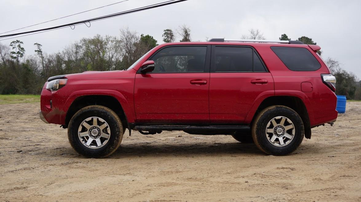

If this is of any help to you, this is mine with the 6112's and 5100's.
Fronts set at max height (7th clip on driver side and 6th clip on passenger side)
Stock UCA and still have to get an alignment. I'll let you know after Saturday when I can try to go in for one somewhere.
Stock rear springs. Although I do have ToyTec springs I'm planning on putting on just before I get larger tires.
