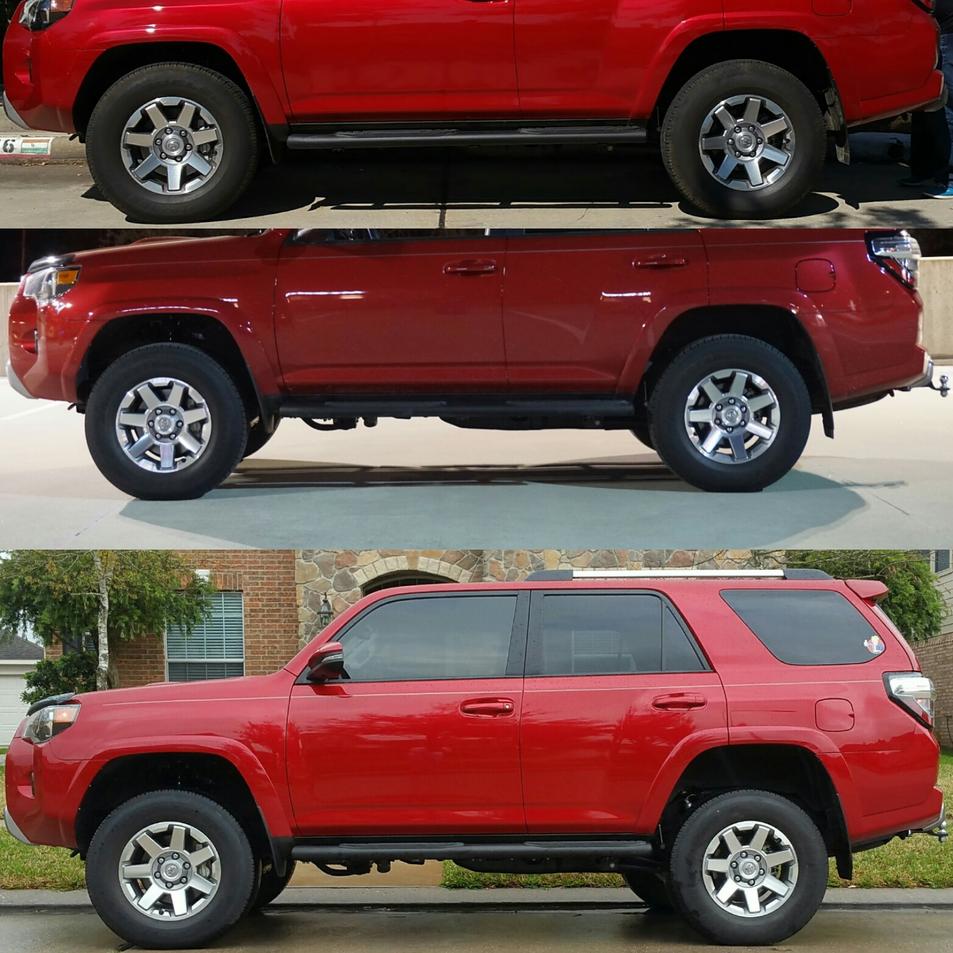

If this is of any help to you, this is mine with the 6112's and 5100's.
Fronts set at max height (7th clip on driver side and 6th clip on passenger side)
Stock UCA and still have to get an alignment. I'll let you know after Saturday when I can try to go in for one somewhere.
Stock rear springs. Although I do have ToyTec springs I'm planning on putting on just before I get larger tires.

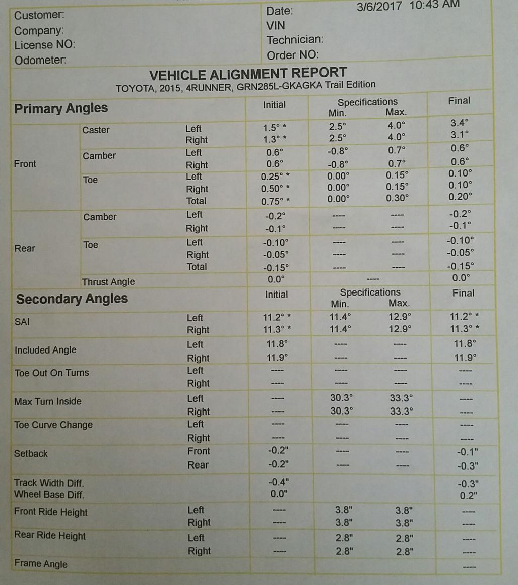

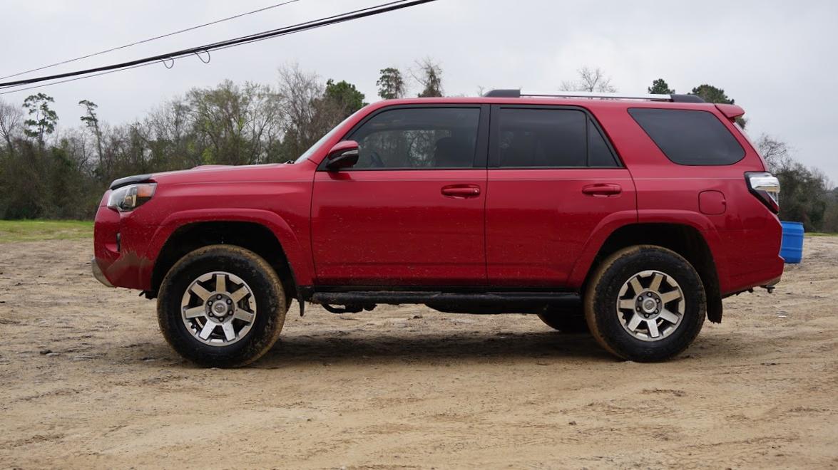

Late reply but I got my alignment and threw on my rear lift.
Here's the specs and how it looked over the course.
Also, I think they have the ride heights reversed at the bottom there.

looks good! which rear coils did you end up going with?
Thank you! Sorry for the late reply. I'm using the ToyTec Superflex coils.
Looks good. Which springs did you go with? 2”?
Also, how do you like those JBA UCAs? Any squeaks or anything?
Thanks! Yes, ToyTec Superflex 2" lift I believe is what it was.
The JBAs at the time felt much better than stock as far as handling. I'm still searching for another shop to do my alignment. I've messed with different clip settings so much since this past February and still need an alignment so handling isn't the best at the moment. Plus I think offset preload could be my culprit for shops never having been able to get my vehicle to track straight down the road. It was just easier to keep straight.
Had them on now for 7000 miles. No squeaks. The top portion of the silver ball joint cap has developed some rust. Tried sanding some of it away but I'll probably just spray some type of rust prevention on it to minize it.
