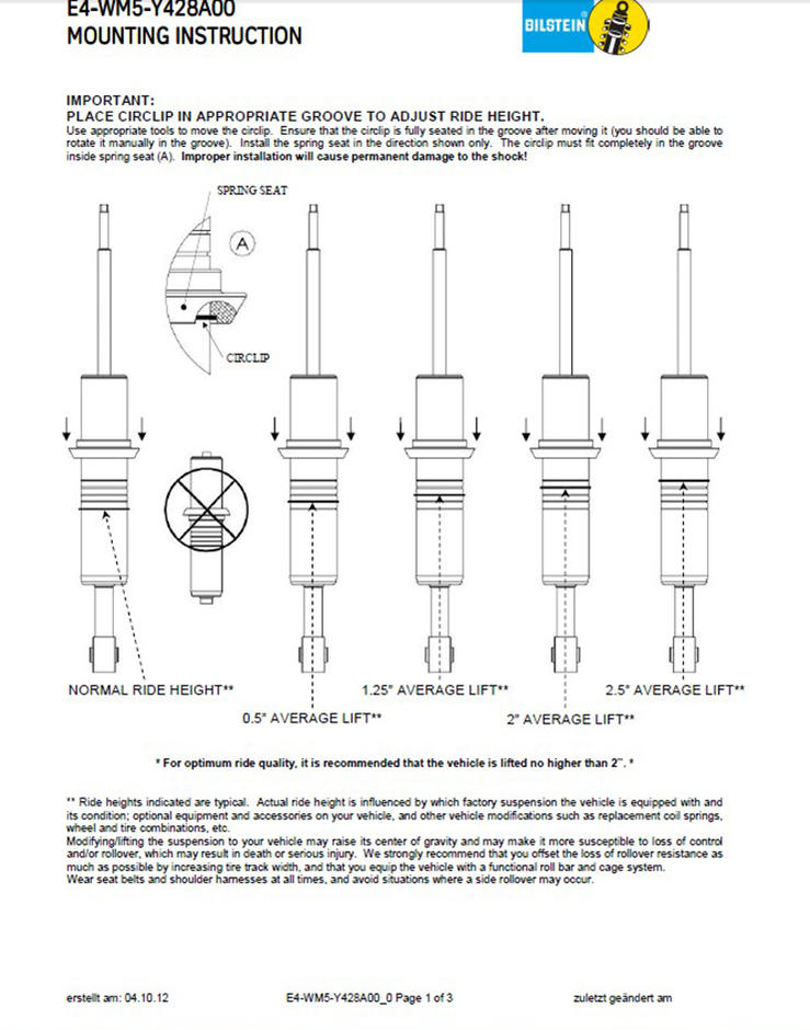

When I set up my KDSS Trail with TRD shocks (very, very similar to 6112s), I ended up at equal perch settings to level it from driver to passenger side (TRD Pros have one side set higher than the other to accommodate for fuel/driver weight).
How high you want the front end should be relative to what you're doing in the rear. Pretty sure there is a Bilstein PDF running around that shows the different heights:

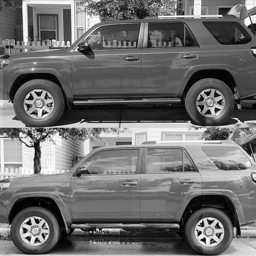

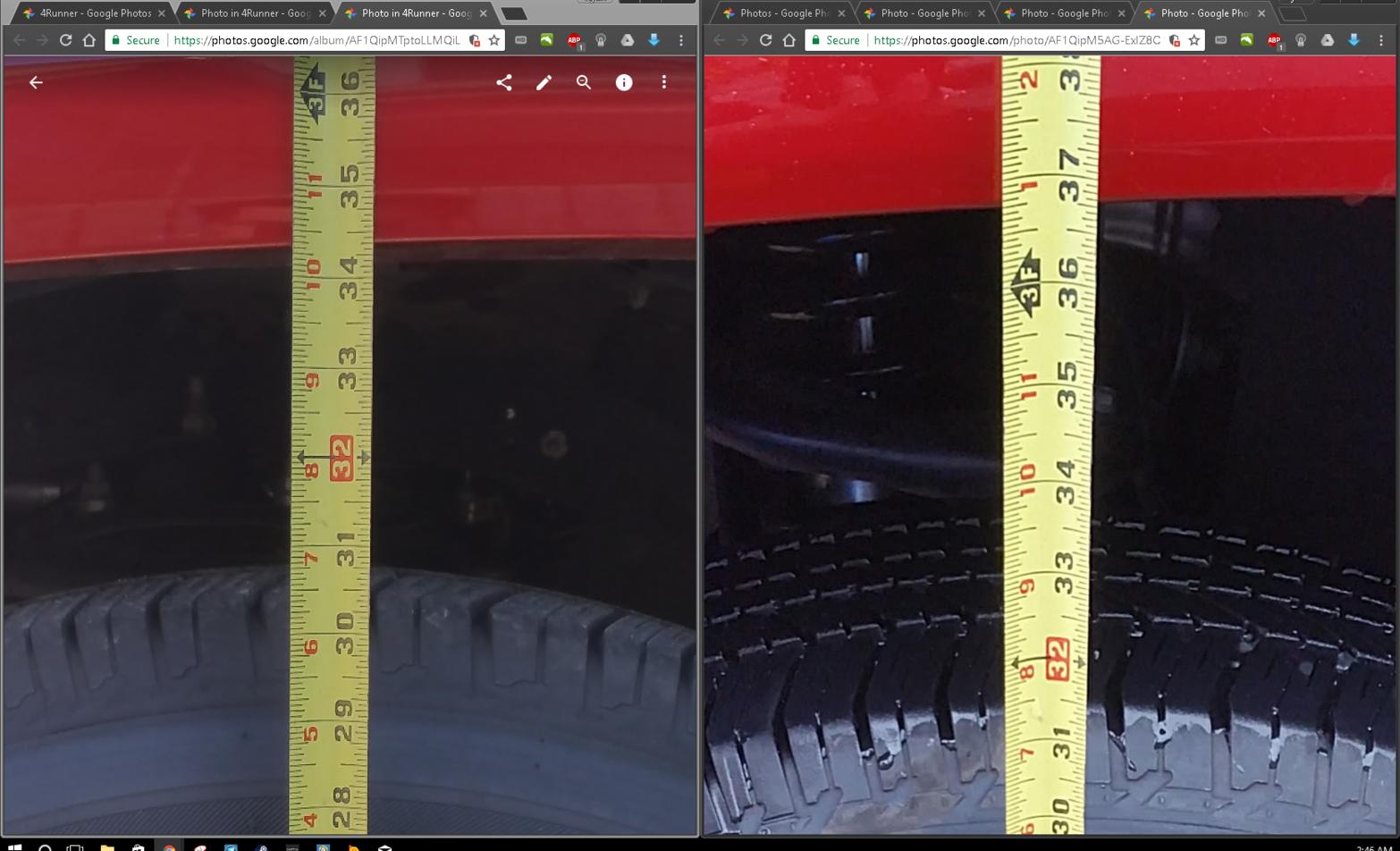

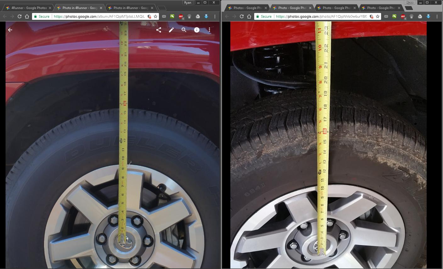

Took these measurements before I installed my 6112's earlier this year.
Revised version using clip 7 on driver side and 6 on the passenger side.
Not the best angle for the afters but it sits just around 22.5 from the hub to the fender and 36.75" from ground to fender. Hope it helps. These are just the driver's side. The passenger side (not pictured) actually still sits a quarter higher to this day. Doesn't bother me. Maybe a 7/5 clip setting could fix that. Everyone's mileage may vary though. I just went by the instructions though.
I actually took measurements this past weekend but I can't remember the numbers off the top of my head. But the passenger side is indeed a tad higher since install in February.
hub to fender
ground to fender

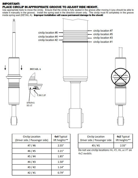

In for this as well. Based on what I've read KDSS requires setting on the same notch to remain level. The question would be, does the #2 notch on the new 6112's start the KDSS owners at 0.79 or 1.14?
