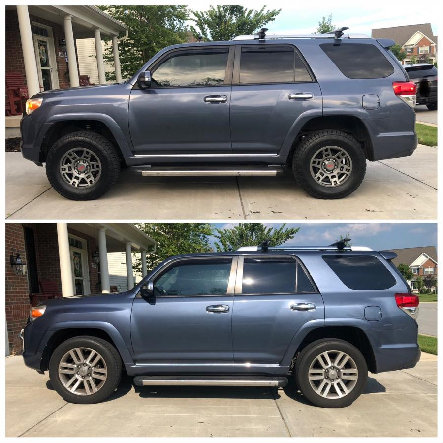

Hey rrsuby25rs,
I did move forward with the install.
I decided I would try to just level the 4 runner and if worse came to worse I would add the 1" lift and 5160's to the back if I overshot the front lift.
Luckily I think I nailed the front lift using 5 on the drivers side and 3 on the pass side. My 4runner does not have KDSS. The truck is stock otherwise for now.
I love the ride so much more now that I replaced the factory shocks. No more nose dives. I hope this helps!
I should add that this picture was taken minutes after the install. The front has settled down a little bit since this photo. I just don't have a new pic right now.

Falcon Kit
So, I totally changed my mind and went with the fairly new Falcon Sport/Haul kit instead.
TOYOTA 4RUNNER | Falcon Shocks
I've only been running it for a day but I had my local shop rip out the XREAS system fully and install this. All went really well, it rides way better so far that I can tell and it looks pretty tough too. I swapped out stock 20" rims to TRD Pro grey rims along with new Nitto's.

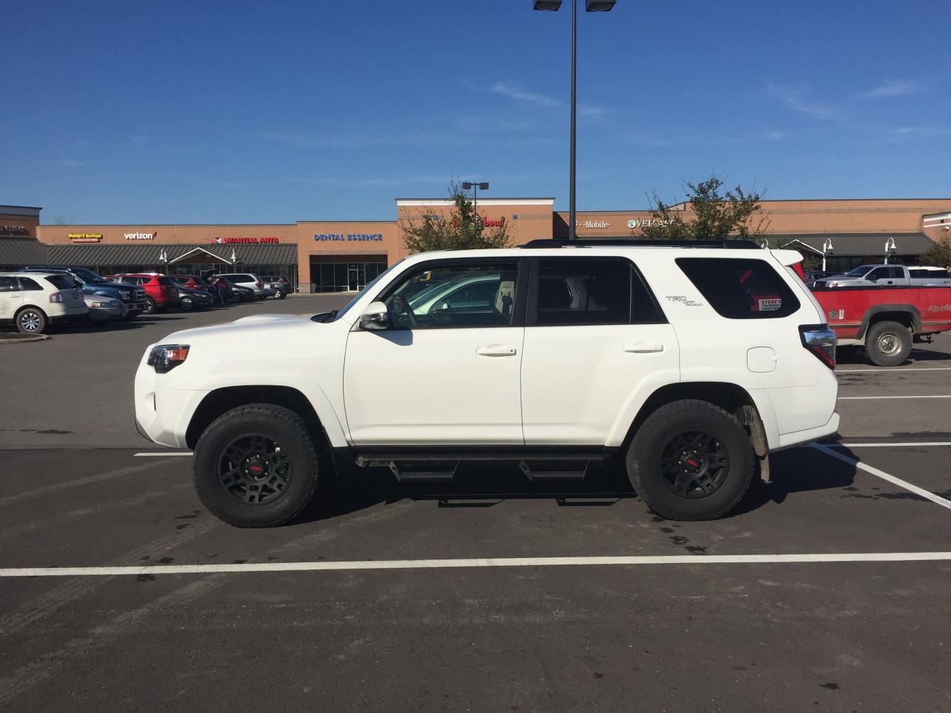

Reviving this in hopes that someone has used the 6112 at the 5/3 setting to get approximately 2" up front and used a 1" spring in the rear to keep close to stock or w/ some rake. Considering the Bilstein 1" spring or the Dobinsons 599 for the rear.
If I bought 6112 and 5150s for a 2016 pro to replace the stock bilsteins and wanted to keep it at the stock height it came with which is what I think is 1 in over regular 4R. Would i set the clips to #3driver #2 passenger? That equates to 1.14
This thread was helpful when I installed 6112/5100’s and B12 coils back in January. I went with standard 600 lb front springs on setting 6/4 for non-KDSS. Reporting back with a 6 month measurement in the event it helps someone else.
I’ve put just over 4k miles on, no squeaks, drives is still very smooth. This is a DD, it has seen no serious off road use.
Just took measurements on flat ground and find no settling. Below is before measurement center hub to fender : actual lift achieved - current measurement center hub to fender … current measurement bottom of wheel to fender.
DF 19.5” : +2.25” - 21.75”… 30.625”
PF 19.875” : +2.125” - 22”… 30.875”
DR 21.75” : + 1.25” - 23”… 32”
PR 21.75” : + 1.25” - 23”… 32”
