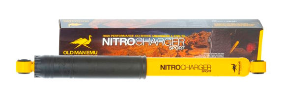

Not too steep of a price...I'm running the OME Nitrocharger Sport Rear Comfort shocks (60028) with my 890's. ($228 pair) I did a ton of research on this site and came up with the ride that I wanted, mostly a pavement pounder carrying hiking and climbing equipment, dogs, etc...but also a weekend "moderate trail" warrior.
Strong but extremely comfortable ride. Good luck on your upgrade.
