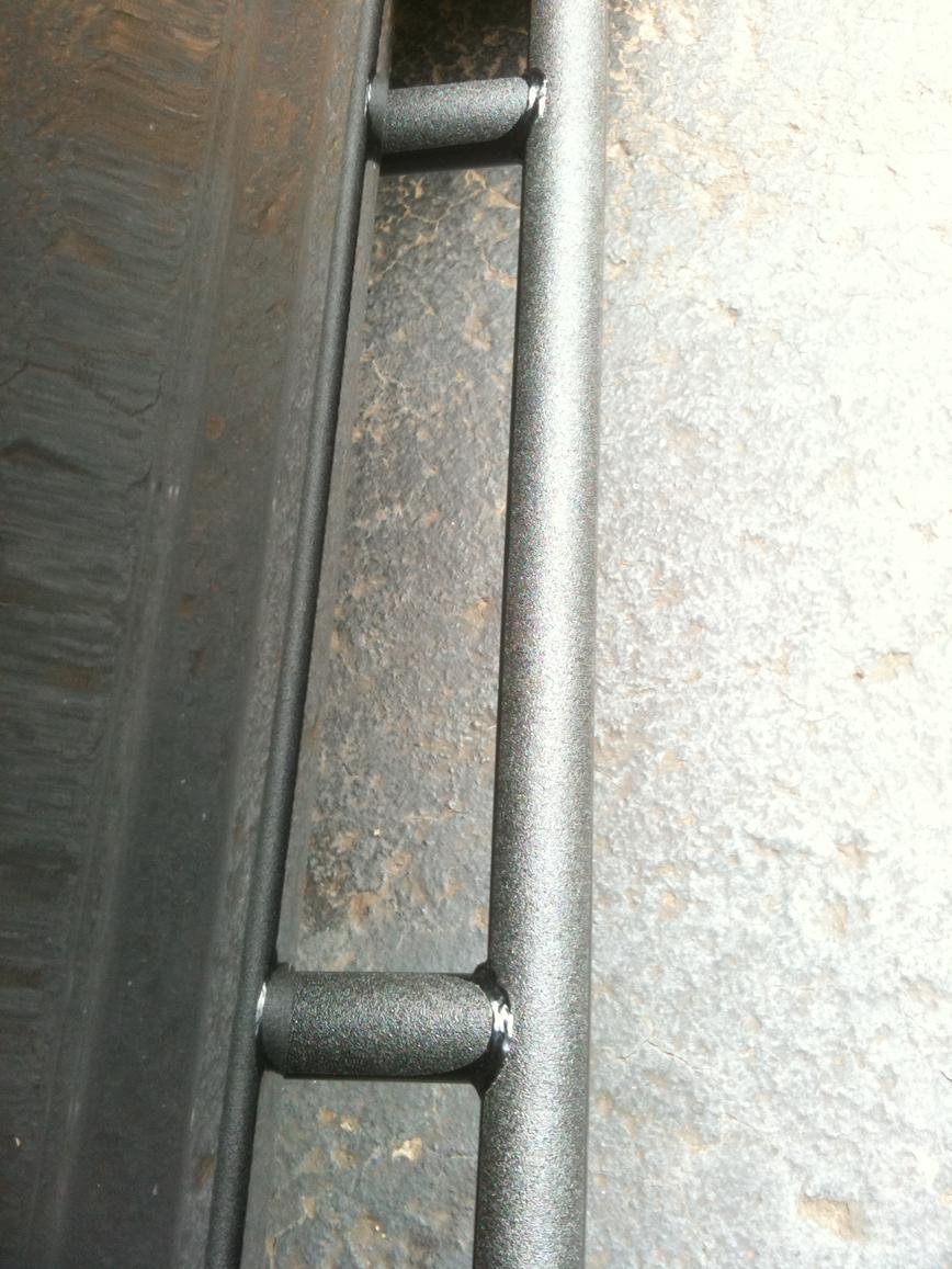

I used the graphite on my sliders
<a href="http://s982.photobucket.com/user/SHALAKO123/media/Mobile%20Uploads/image-30.jpg.html" target="_blank"><img src="http://i982.photobucket.com/albums/ae307/SHALAKO123/Mobile%20Uploads/image-30.jpg" border="0" alt=" photo image-30.jpg"/></a>
Covered in mud though :sorry:
Looks great like that, haha! I'll probably experiment on my skids when they come prior doing the bumper and sliders.
