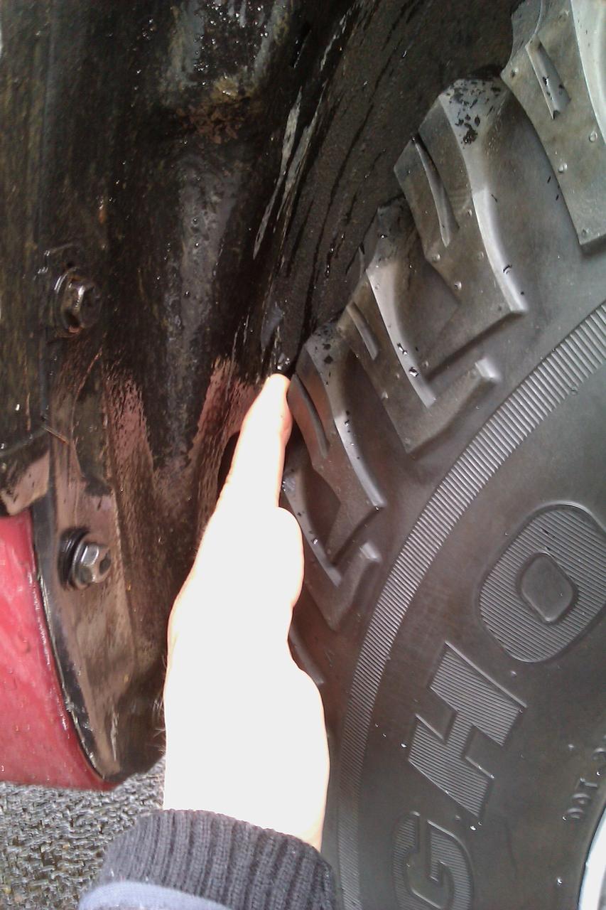

what!? your saying 4" of lift? are you for real, im running 285s with no lift... you do not need a lift to run 285s, sure you will have some minor rubbing at full lock and full flex, but if the truck is not going to be a wheeler then you will never fully flex it out and 99% of the time you will not notice the rub...
to the OP you most certainly do not need 4" of lift, just go with a 2" if you dont want rubbing and call it a day
They'll rub almost as bad with a 2" lift as they will with no lift.
and they barely rub at that... i should know, im the one running them(sorry not trying to sound like an a$$) but it gets frustrating when every one is telling people that you have to have a lift to run them... you dont! the OP stated that he/she didnt want to get a big lift, to me that means that he/she is not building the truck with the intentions of wheeling it or offroading it much. he/she is mainly going for looks, and you can fit a 285 under a stock 4runner with out lift. i do not experience rub in day to day driving, the only time i will experience when not 4wheeling is when i am turned to lock and drive over something, like into a driveway ect. and lets face it, how often do you turn to lock and drive, hardly ever, maybe in a parking lot, but you shouldnt have to drive over anything in that situation... so i cant really see as how it would bother anyone. i get a little rub off road a full flex but i know what it is and so its of no concern. a 285 will fit and for the most part go unnoticed in day to day driving, now if the OP had a 2002 limited i might say sure you will want some lift, but the 00 will sit just as tall as mine. here is a pic of mine when i put my 285s on to see how much clearance i had, this is turned to lock(i only rub on the frame rail behind the strut -not going to damage a thing) IMAG0621.jpg

All good kid, no offense taken. The OP asked what size lift he/she needs to run 285's. I understand 285's fit. But to run them right (which to me means without rubbing) a 2" lift isn't going to cut it.
and they barely rub at that... i should know, im the one running them(sorry not trying to sound like an a$$) but it gets frustrating when every one is telling people that you have to have a lift to run them... you dont! the OP stated that he/she didnt want to get a big lift, to me that means that he/she is not building the truck with the intentions of wheeling it or offroading it much. he/she is mainly going for looks, and you can fit a 285 under a stock 4runner with out lift. i do not experience rub in day to day driving, the only time i will experience when not 4wheeling is when i am turned to lock and drive over something, like into a driveway ect. and lets face it, how often do you turn to lock and drive, hardly ever, maybe in a parking lot, but you shouldnt have to drive over anything in that situation... so i cant really see as how it would bother anyone. i get a little rub off road a full flex but i know what it is and so its of no concern. a 285 will fit and for the most part go unnoticed in day to day driving, now if the OP had a 2002 limited i might say sure you will want some lift, but the 00 will sit just as tall as mine. here is a pic of mine when i put my 285s on to see how much clearance i had, this is turned to lock(i only rub on the frame rail behind the strut -not going to damage a thing)View attachment 57434
LMAO. Who puts on 285's for look. People plan on using there 4runner so it will flex. My 265's rub when I flex and or turn at full lock.
