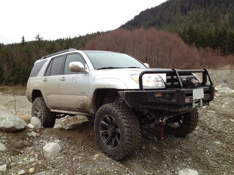

Agreed, its all personal preference... I do a bunch of wheeling and as nice as it is to have the smaller wheel to really air down the tires, I'm still rockin a 20"rim on my 35s. I definatly air down alot less with the bigger wheel, but have a very aggresive tire to make up for it. Rear air locker helps big time.
