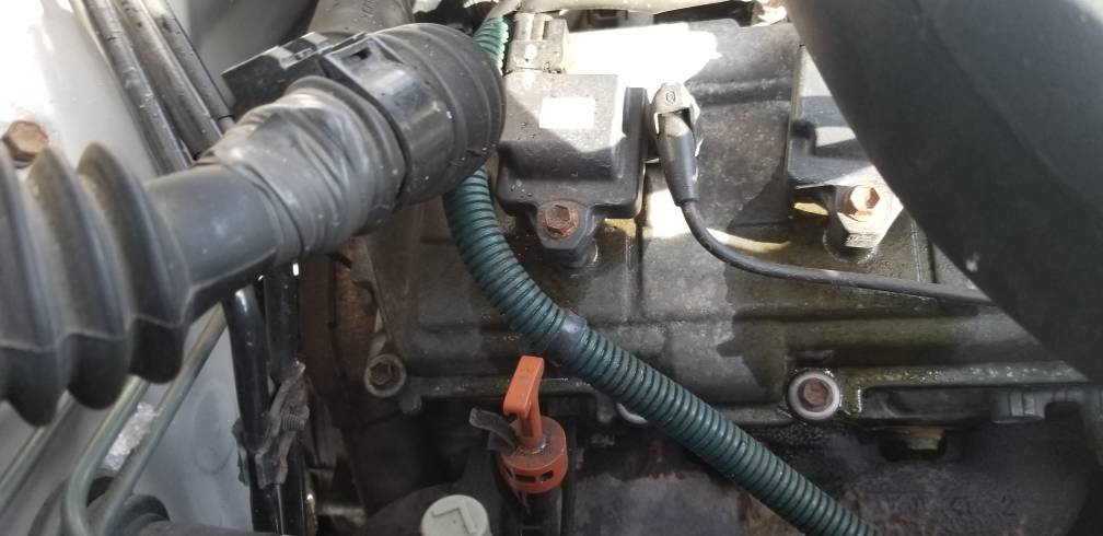

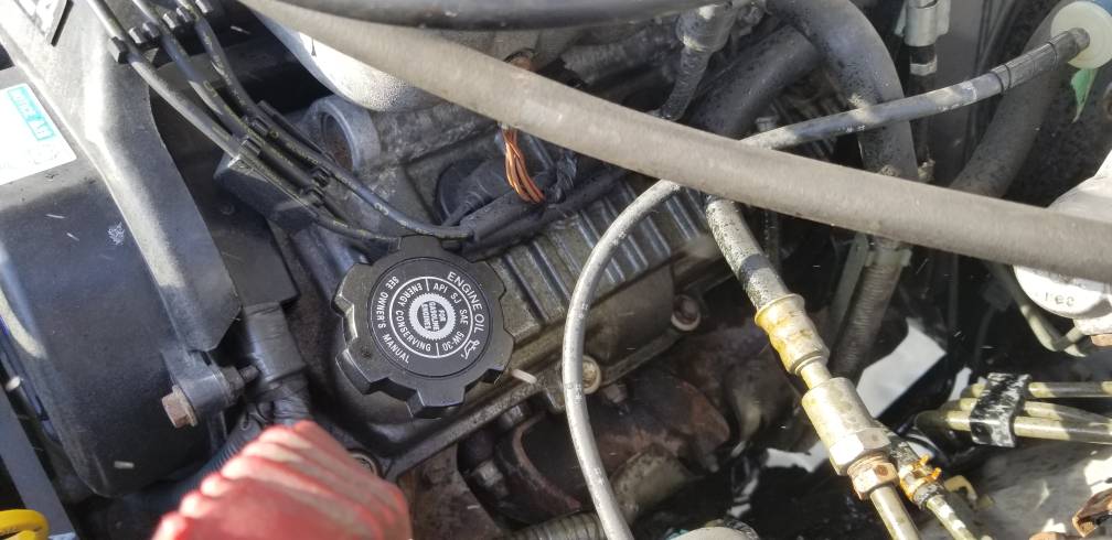

I just left work and my truck started up just fine as expected. About half way home (15 minute drive) I started smelling something burning (like oil).
when I got home I quickly popped the hood to see what was going on and found oil all over my engine! It appears oil puked out of several of the spark plug tubes onto the valve covers.
This has never happened and the truck otherwise does not drop one speck of oil from all things valve cover gaskets related.
what the hell happened? the pcv valve is maybe 2 years old and the grommet was replaced at the same time.
I'm concerned because I'm about to leave on thursday night for a 4 day ice fishing trip up north. It's supposed to be a little warmer on Friday and pretty mild the rest of the weekend.
I checked my oil level and it was maybe a 1/4 quart low on the dip stick.
Should I reconsider taking my 4runner or is this a known thing to happen when its bitterly cold like this?
the truck ran normal and wasn't making any funny noises or anything, just the smell from oil burning. I also let it warm up for a good 15 minutes before I drove it.
Pix

I cleaned off the oil with some brake cleaner, let it dry and fired it back up again. I didn't see any new oil come out initially but after 5 minutes or so, it was coming back out of the spark plug tubes again. I shut it down.
I pulled off the PCV valve and it passes the "shake test". I did not see any moisture/ice in that hose.
So what could cause this excessive crank case pressure? This isn't the first time this truck has seen brutally cold days and this has never happened.
Should I replace the PCV anyways?? I've never heard/seen this before....
