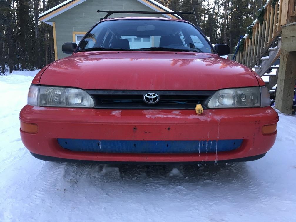

Here's my pretty winter front. With the weather we have been having the last couple of weeks, it really helps. Makes a big difference in cabin heat and by extension engine temps. Been -30 F some mornings. No 4runner pic. She's hibernating.
Just a thought. I rarely start up in the cold weather without plugging in. My engine (and PCV) is above freezing before I turn the key. Do you have a block heater installed?
