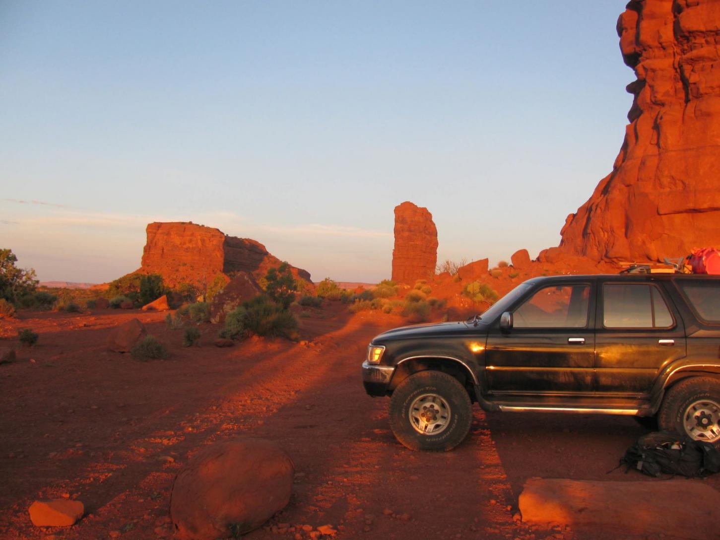

I reckon she might have a bit of sag but the current setup is 31x10.5x15 I do like this size but feel there’s some space to fill in those wheel wells.
I think I can go bigger from reading on the forum and from seeing her fully flexed with room to spare. The rear being my main concern.
I’d like to go 32s or possibly 33s but the real question is 10.5 or 11.5? I dig the wider tire and correct me if I’m wrong but I think it’s better on the beach? That being said it is a 22re so 33s on the hills we have might be pushing it.
I don’t want to lift right now although after hitting some real deep spots where I was pretty sure I’d bottom out made me think about it for the future.
I wish i could see and try all the sizes mounted up but I don’t think a tire shop is gonna mount and unmount a brand new tire for that purpose.

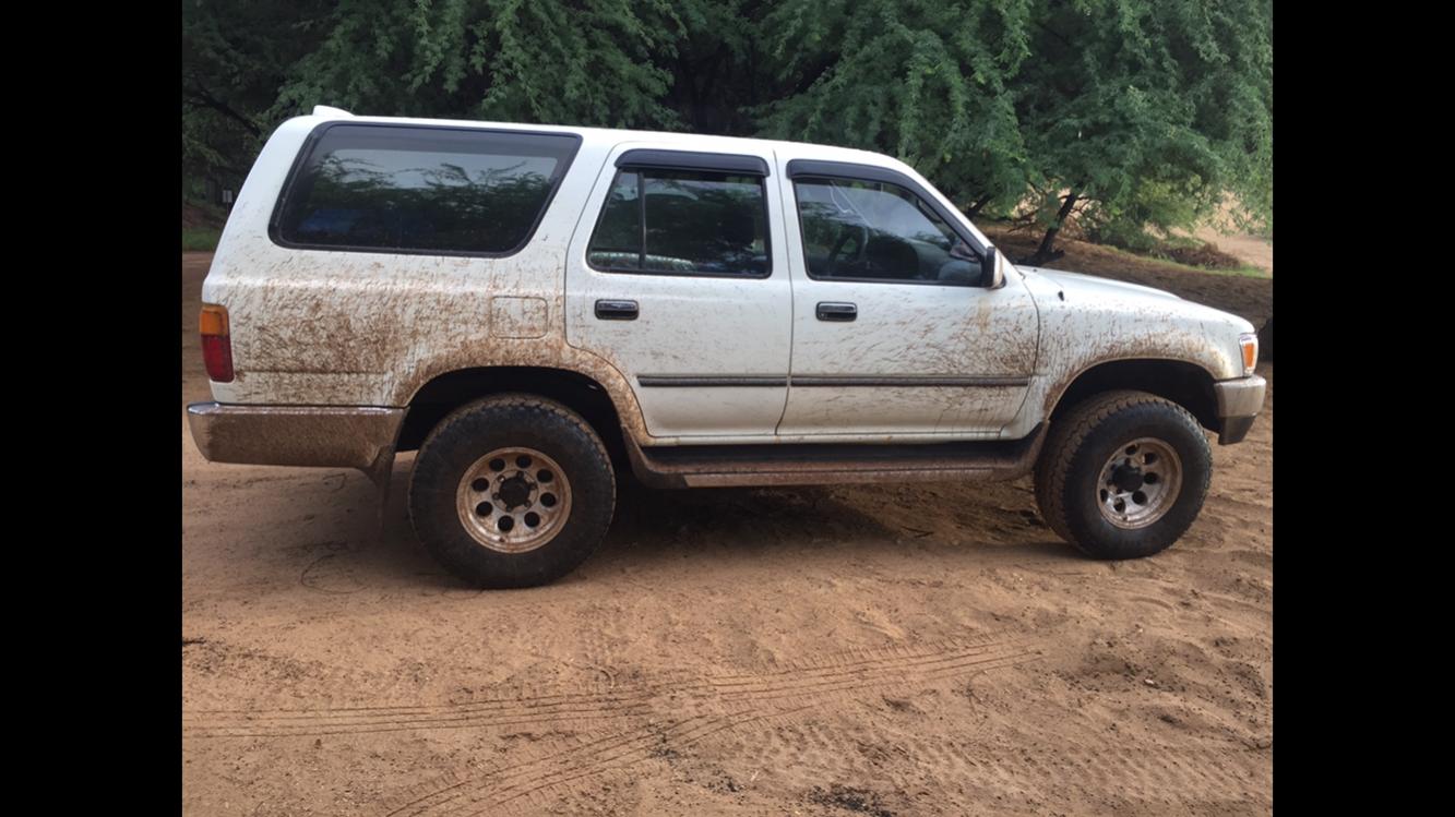

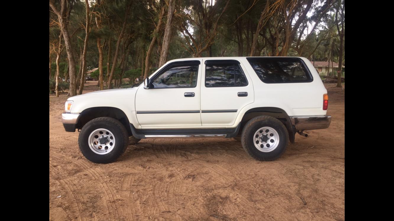

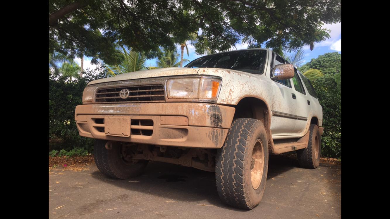

Here’s some shots so you all can tell me if the ass is sagging or if it’s close to stock stance. My one concern is that I do plan to run a hitch mount motorcycle carrier and I know that will sag the ass more and risk rubbing
All clean!
And a few days later all muddy. Posted up at the end of the road Polihale

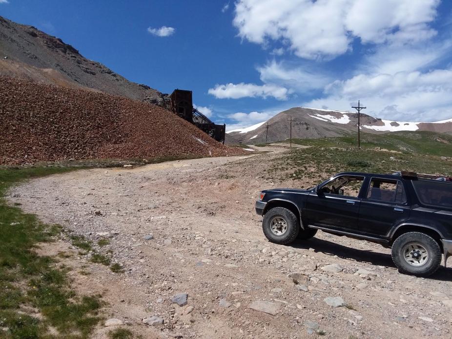

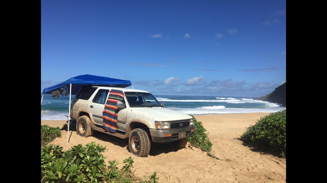

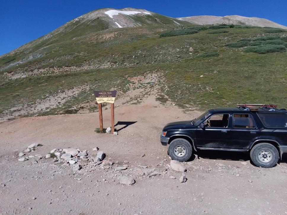

33x10.50 is my favorite tire size for decent height and width. It might fit on yours but a slight lift may be needed to effectively clear the 33s.
I have 33x10.50's on my '94. No rubbing in the front ever, but a little in the back if I really stuff the wheel. It just rubs against the plastic inner fender, and only under extreme conditions, so I don't worry about it much.
Here are a few pics from some backcountry trips, so you can see how it looks "in its element".
I didn't regear. It's geared for 31's at 4.56, so the change to 33's wasn't that big a deal. It's noticeable, but with a manual you can adjust your shifting patterns to compensate.
I'll put the same size on next time I change tires. I'm a pretty big fan of the BFG KO2's.

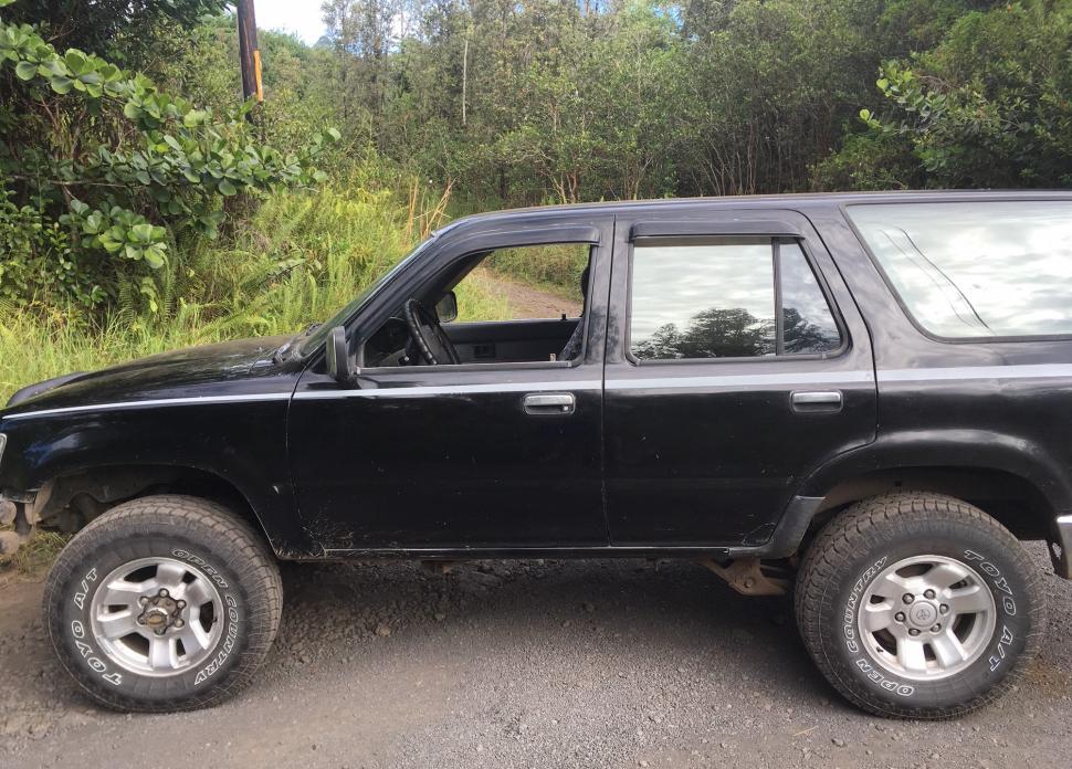

265/70r/16
That's what I went with when replacing my really old tires recently. I love the look and can't really notice any lack of power from the smaller tires on previously. No need for anything bigger for me, for sure.
