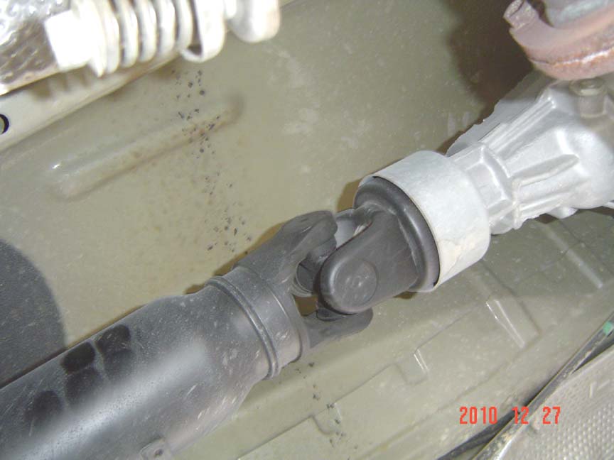

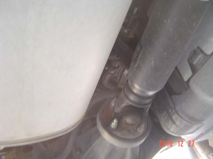

I looked for front/rear U-Joint Zerks when I inspected my used 07, 2WD T4R. I did not see any as I hear the 4 Wheel Drives mention at the yoke or front splines vs the U-Joints. “In Old School”, this was an after market vs Factory Zerks at U-Joints vs Splines to Trans. But! Quick Turns back and forth and feel and look for play in front and rear U-Joints with the rear wheels off the ground ?? (might show some U-Joint Play). If they are bad enough to cluck, you might see a dry powder look at the bad joint.
How many miles are on the 07 and how has it been used related to excessive torque on the U-Joints? My attached Pics are not that good but I d/n see or feel zerks.

Since I have a 4wd, I haven't actually seen a 2wd driveshaft on the 4Runner, but if these pics are of the 2wd driveshaft, then there isn't a 'slip' joint in the driveshaft like the 4wd version. You can see the flange connection at the rear differential (same as the 4wd version), but the front connection to the rear of the trans is not a flange connection (like the 4wd version ). Instead, the drive shaft splined yoke slides directly on to the splined output shaft of the trans. It is this connection between the driveshaft yoke and the splined output shaft on the trans that acts like a slip joint. With this type of splined connection directly to the trans output shaft, the 'slip' joint is directly lubricated by the transmission fluid, so no zerk fitting for grease is needed.
Thanks, I was wondering about that.
