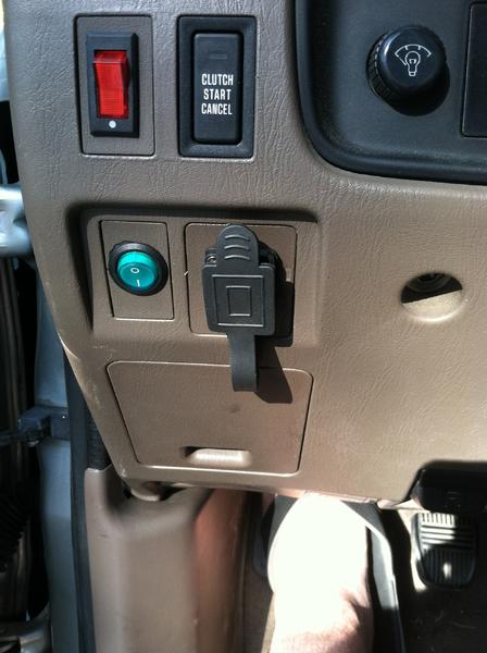

I have the XRC10 w/ synthetic cable. I've had it less than a year now, and so haven't really had to put it to use, but the hard rain is comin and I'm sure I'll get stuck sooner or later.
The only trouble is the relay, if you go this route, take it apart and seal it. I didn't at first and when I did a test on my winch, the relay was frozen, I just tapped it and it started working, but when I took it apart to clean it up and seal it, the rust was taking hold. It still works and now it's sealed, but it was full of water.
Also, I relocated the joystick connector, since I took apart the massive 'control box' to mount the relay.
