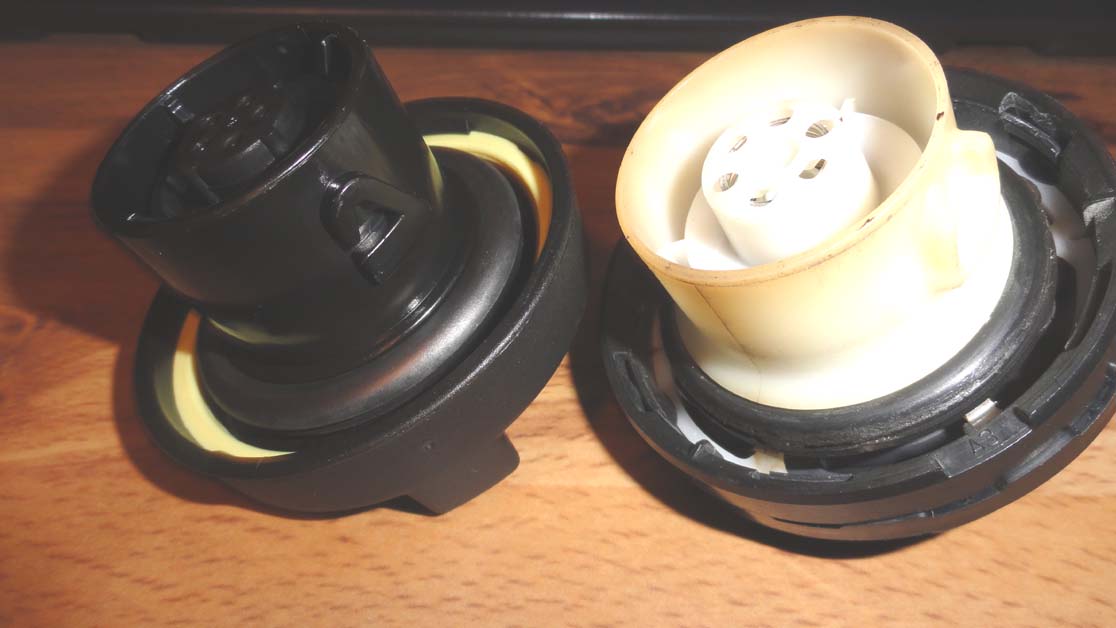

1. I took the advice of getting the truck scanned for a code and it showed a small leak at the gas cap. I d/n think to ask the Tech for the code vs him telling and what it represented.
2. At this point I noticed no resistance of a seal on the cap and the good bad “Soft O-Rings” shows why. Plus, the old was not pushing the cap off enough to help remove the cap.
3. The Tech said the light should reset later. I asked if the scanner would detect the leak as solved and it did (the light also went off).
4. To and from the Auto Store the back driver’s side window went down on its own. Is there a connection there?

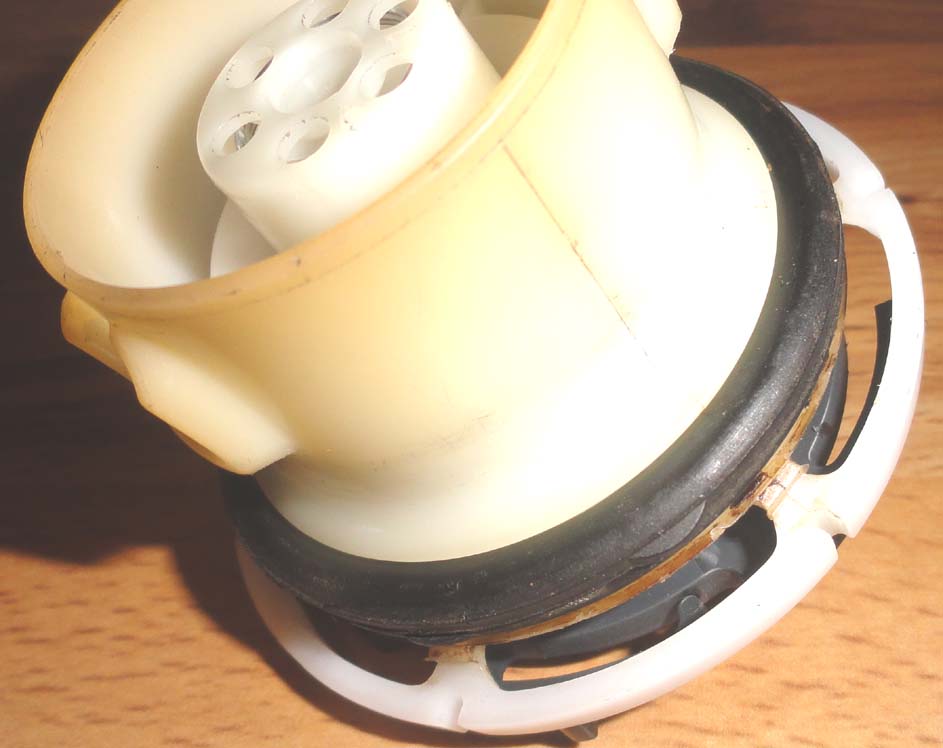

Follow-up on gas cap replacement is not as bad looking today as yesterday (even though the lights are still off.). The original O-ring looked flattened and worn yesterday but not today (attached) after resting over night off the tank. It looks just as full as a new O-Ring today and feels better with normal O-Ring density vs the foam rubber the new has.
1. There was a statement related to the cap being on correct. From seeing the original O-Ring initially, it looks as if the O-Ring was not aligned good or over tightened. I felt alignment was automatic. Can you over tighten (past 1-2 clicks) and cause bad alignment?
2. Without looking back for an answer, is that code still stored or was it cleared when the lights went off? If it is still there, I’ll go back and get the actual code. My reasoning is to know this was the fix needed vs other Sensors/Etc needed while I have an extended Warranty on the truck.
3. What are the factory warranties/yrs related to emission items? Even though my warranty was requested and sold as Bumper-To-Bumper (which has been questioned by the provider over the Dealer’s contract of 6 yrs on the 07)?
Thanks For Your Help
