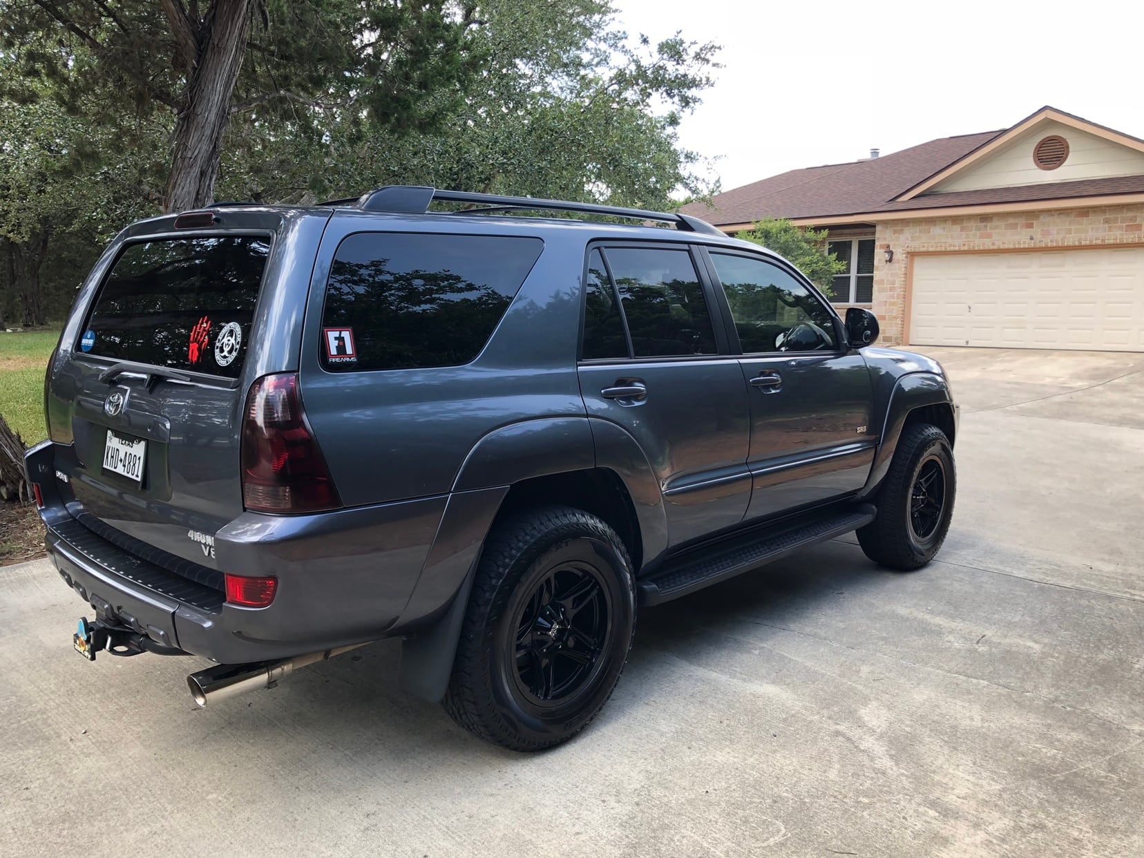

Trying to get some tips on what to do next to her.
My mind is thinking:
- True dual exhaust mod with better tips
- Brand new suspension since this is original
But I can’t really think of a whole lot more.

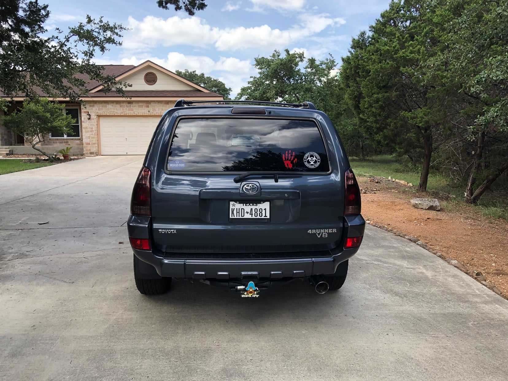

Interesting you put a V8 badge on the rear hatch, but pulled the one out of the grill....never seen that before lol!
Haha, it’s actually the badge from the grill. Wanted to change it up a bit so I took it off, peeled it off the plastic part and then threw some adhesive on it for the back
Between the two options you listed: SUSPENSION.
Whether or not you lift it, your daily driving will feel SO much better and also react more safely in an emergency maneuver situation. I've never read any post of someone who was sorry they got new suspension.
new suspension
I would say go for the new suspension.
Looks like you plan to keep it on the pavement, so no need for a lift. But since this is a 2005 or older (I don't know the miles), you've got some age on your shocks and springs. Swap them for something nice (I don't actually have any suggestion) and you'll see/feel the difference in performance.
Not sure what the exhaust would do for you other then sound and maybe looks.

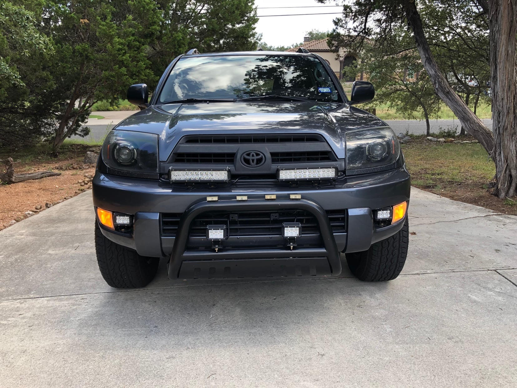

If it was my truck, the first thing I would change would be to remove the "bull bar" on the front and throw it away. Then get a proper plate steel rock bumper and mount all your lights on that. Just my opinion.
If I had the money, I would. But it was cheap and at least something in front. Broke college student here hah
