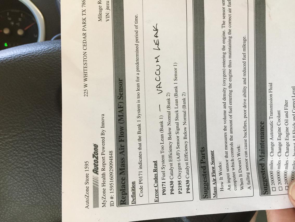

I just got back from Autozone with these codes...the guy said I most likely have a vacuum leak someplace. Where would I start? Thanks guys...
03 4Runner 2wheel...
Yeah, they are 02 codes that I've been dealing with for over 4 years....I changed a couple of the sensors that were required...I had a thread I've got to look up to see exactly which ones I changed for reference which didn't even fix codes then. Spent $200 bucks on sensors for nada!! But the guy at Autozone said it could stem from the p0171 code as a vacuum leak which could throw off the sensors to begin with. Now yes, he's an Autozone guy but it sounded something to look into as nothing else worked. I'm going to bust my flashlight out now and search all hoses for cracks and loose fittings. I also got a new cap 6 months ago which did nothing. More money thrown away. Ugh!! Thanks guys
