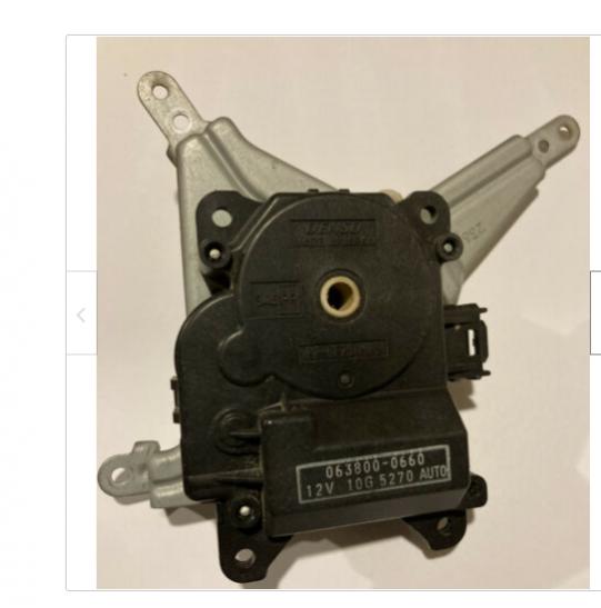

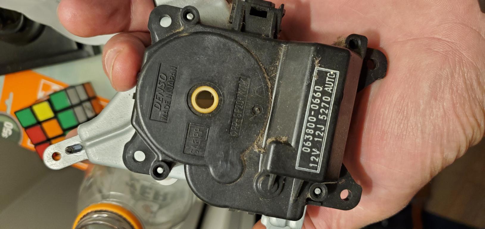

There is but one difference in these model numbers. Can someone please tell me one could replace the other? The difference is on the second line...one has a "12J" while the other has a "10G".
Thanks for your help!

One is in your hand?
Honestly, I wouldn't worry about the 12J or the 10G; if you look at the same part online you'll find those two digits change a lot. In fact, that entire box of numbers is probably some internal Denso part number and batch code, it seems to change quite a bit if you look online under the Toyota part number.
The actual part number is listed as 87106-35120 (Toyota P/N generally are 10 digit which is why I suspect the 063800-0660 is a Denso specific number as it's structured differently.)

Awesome, thank you so much for your input. I received the one I ordered and there's absolutely nothing different in these two servos. Thanks again!
