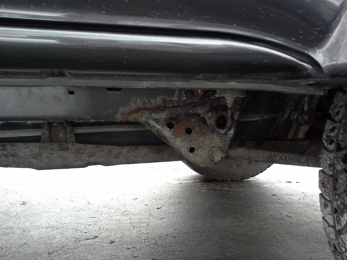

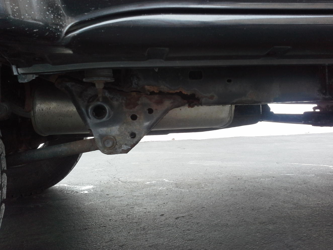

You want pics. You got pics.
Seems the right rear stabilizer mount is about 90% separated with only the rear weld of the mount still attached. Sounded like a CV joint at first but realized it was popping under acceleration in a straight line. Sorta put 2 and 2 together but drove the rest of the 5 miles home anyway without stopping.
I can't drive on it until I can get it fixed. Kind of tough to trade or flip the vehicle in its current condition.

Yup, and Eric at Wetsboro told me he can't help. I could drive it in and he could inspect and report it to Toyota in the hopes that they will finally issue a recall, but that was all he could promise. Too old he said. He also said just talk to any Toyota service manager closer to home. Any one of them can do the same thing with corporate. I called Wellesley Toyota and they said no dice. I would need to take it to a body shop.
I think I am headed to Harbor Freight and getting a cheapo MIG welder. I will try my luck with a crash course in frame repair just to get me back on the road for a few more weeks. No dealers in my area have the Trail Premium I want.
I need to keep this pig a while longer until someone can sell me a suitable rig.

Looks like the same thing I got going on!
Something should be done about this from Toyota. I don't care that it's old, things shouldn't break at exactly the same spot on every truck that see's some salt!
