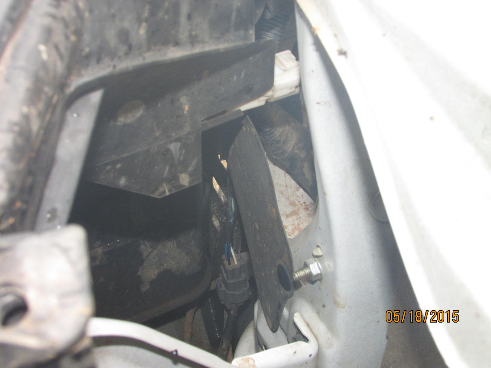

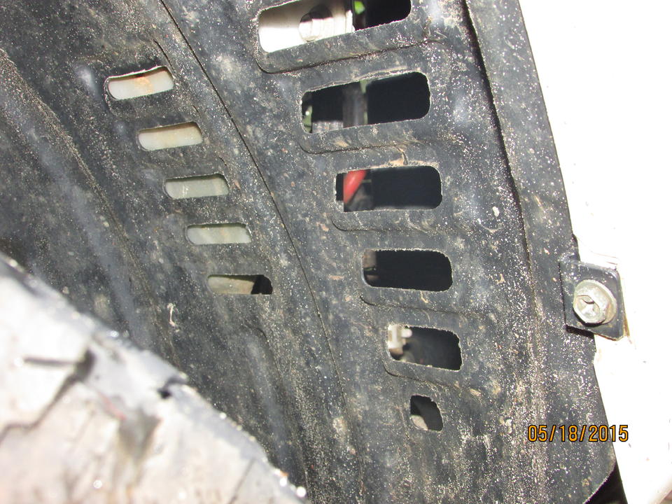

Really? Have you been down there to LOOK at the area? I did several months ago when it came up on the icing question, and again this morning after reading your reply. There is sheet metal covering roughly 1/4 of the intake area behind those vent slots and you can see the grill looking through them. I'm not saying some air doesn't get to the intake opening through there. I'm saying that even though it may have been originally designed for that purpose it is no longer as important because there is as much flow through the grill IN FRONT OF THE RADIATOR as there is through those openings. I am saying you could close those slots completely and the intake would still get cold air through the grill. The red wire in the 2nd picture is the positive lead running from the winch solenoid box to the battery in FRONT of the radiator. And you can see green from the trees in the background above that wire. No, it ain't pretty and smooth, but yes, it does have airflow.
