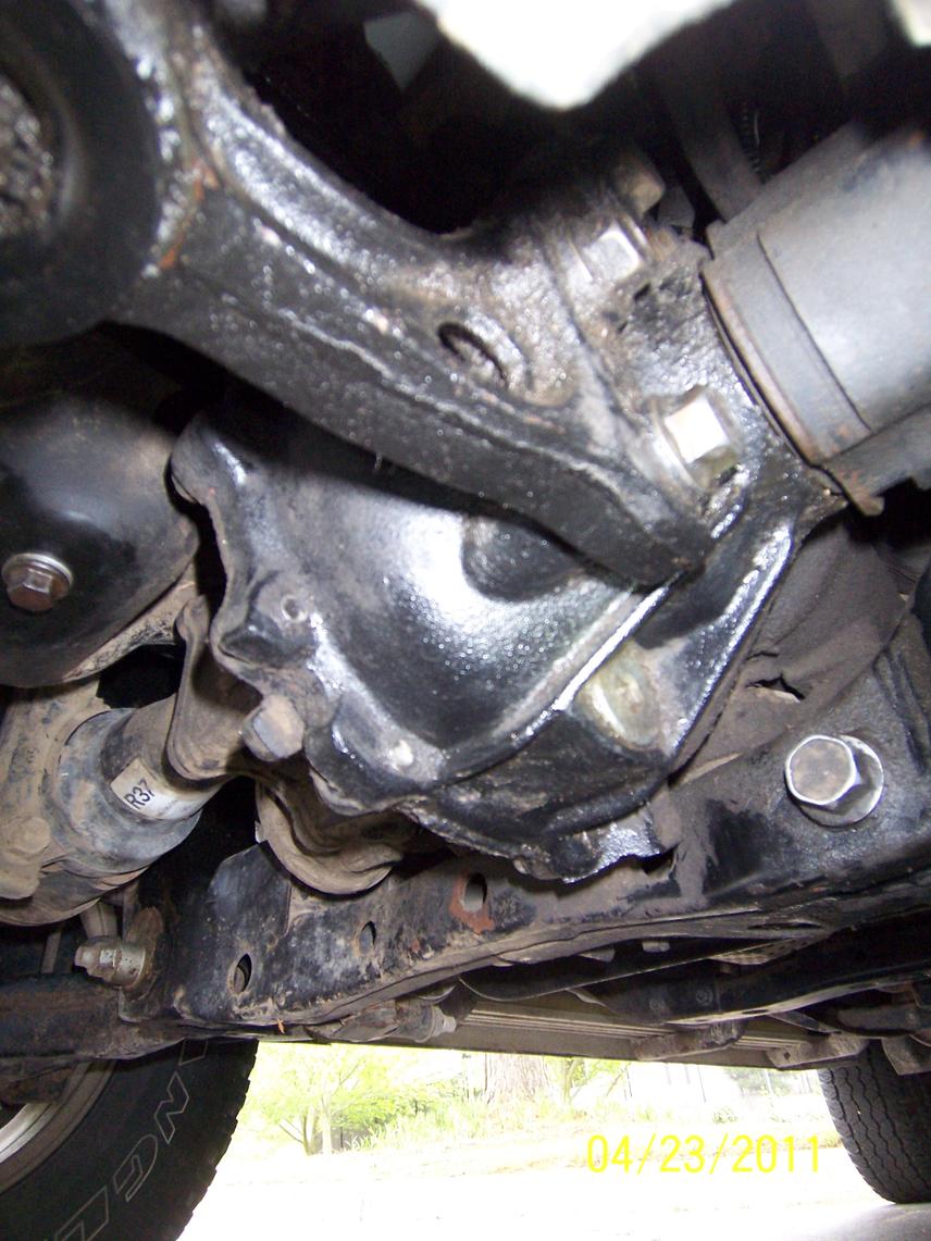

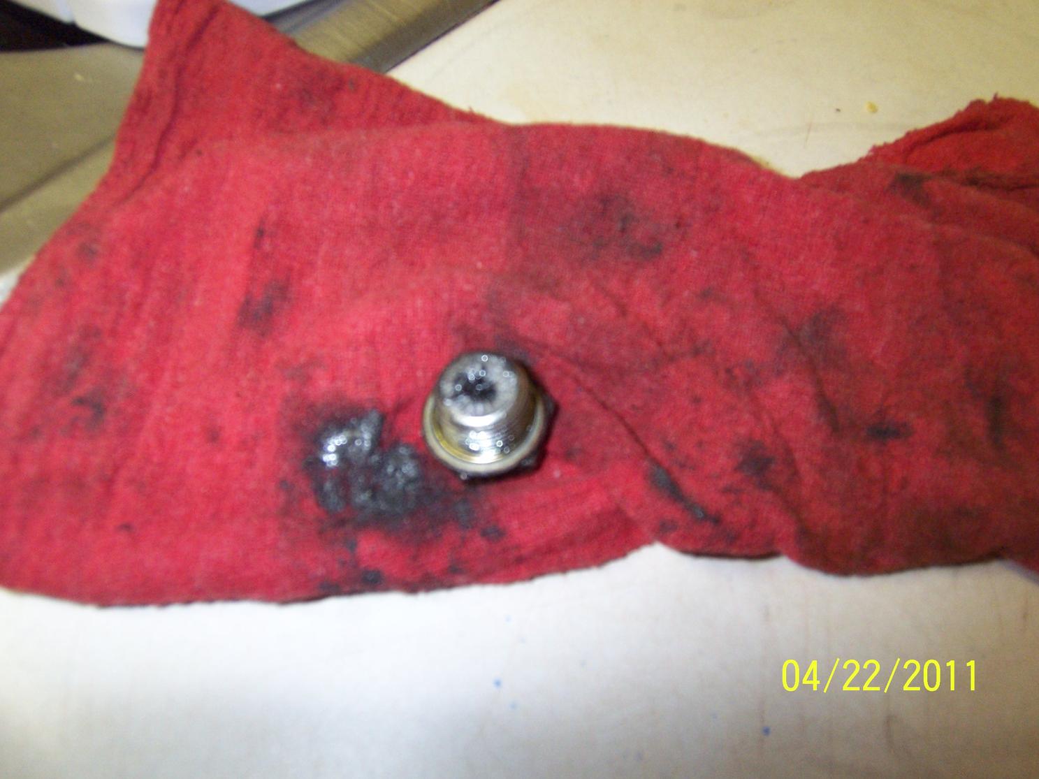

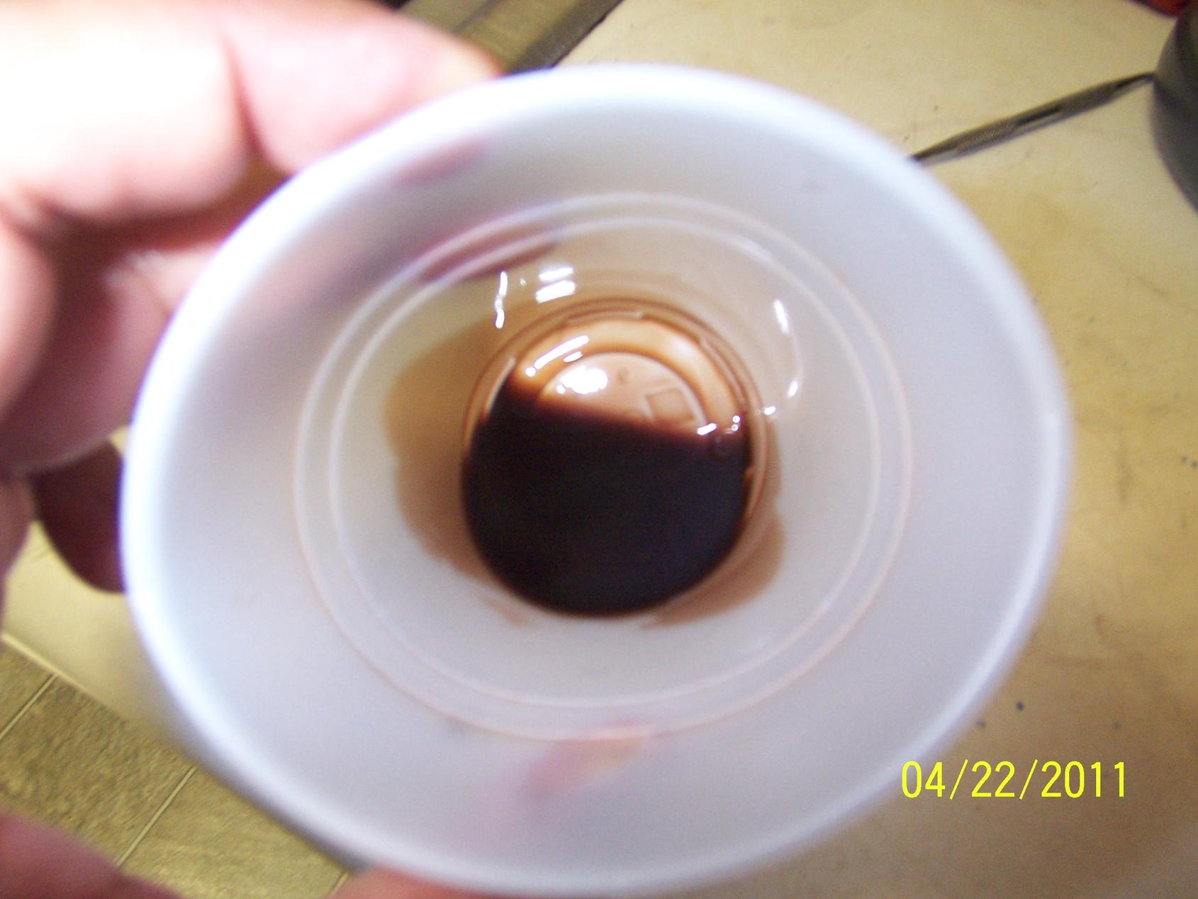

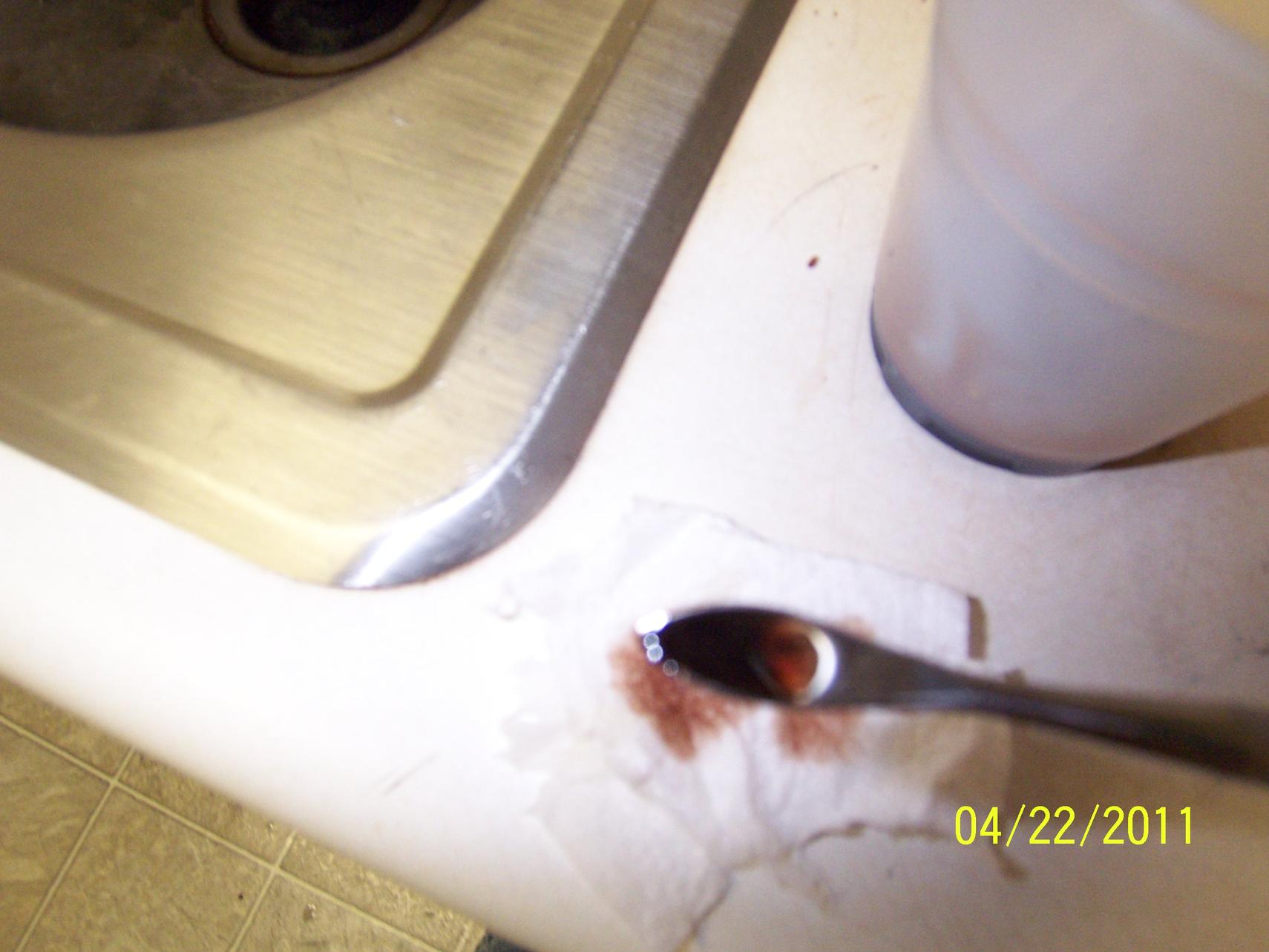

This morning I was successful on the front fill with just the 10mm hex key and a 1' breaker bar, but the drain is presently stuck, I tried the 10mm hex with breaker bar 1st, the key was starting to flex but it would not budge, bought a hex socket set and tried with a ratchet+breaker but nope, bad language did not work as well, now it has a very minor strip and I dont want to f**k with it anymore, none of the dealerships/stores have it in stock either, I am just going to just fill it up and take it in next week, the guy at the dealership said $50-75, depending on how bad it is.......
see pics below
The glass has the tranny fluid sample
The metal spoon has the rear diff fluid sample
The rear diff drain plug
