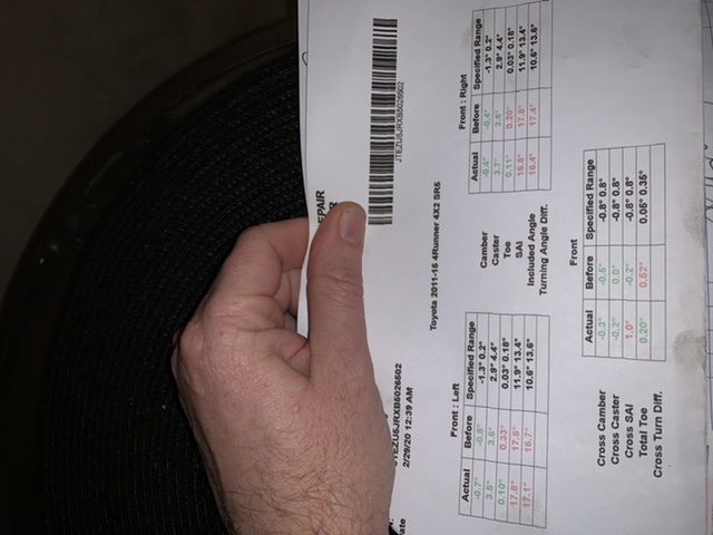

Can someone interpret this for me? Did they get it back in spec? Not sure I’m completely satisfied with the outcome... still a slight right pull on flat ground.

Well, in my experience when you have a pull left or right after alignment even if the # in specs, that means the Toe is OFF . Those guys who did the alignment for you have to play with it a little more. Did mine last week, same story. Good luck with your alignment!
