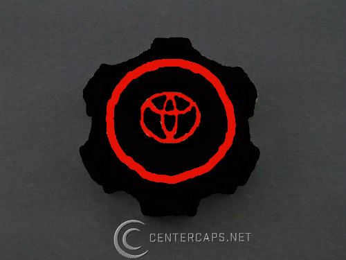

i have been searching for a good while and have not found quite what im looking for.. i am planning on painting my wheels sometime soon and i wanted to paint my center caps a little different. i plan to paint the wheels a gloss black but i want the center caps to look a little something like the pic!
has anyone seen this done or would know a good way to do it? i might not do the circle in red but its just an idea! thanks for the help!

Thin paint, a steady hand and a pinstriper's brush will do that nicely.
well i have some of the touchup paint that you buy that looks like a nail paint brush.. maybe that will work! i used it when i painted my KC lights! i was just hoping someone has done it and has a pic!

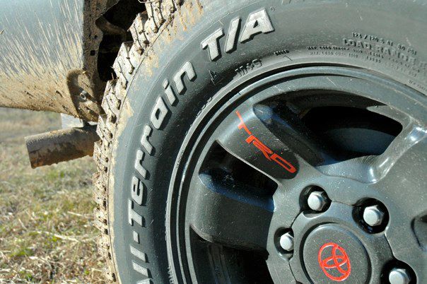

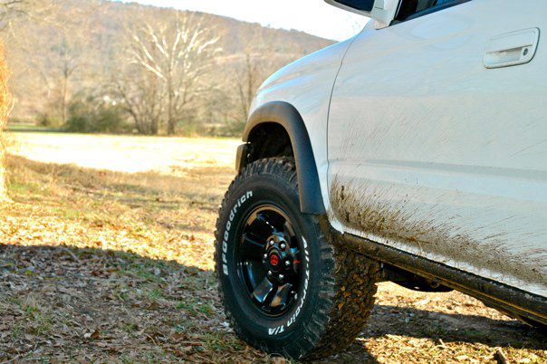

I got this. Used a microbrush applicator got it at a local hobby store for model cars probably. Also where i got the paint. And the TRD is a sticker..
