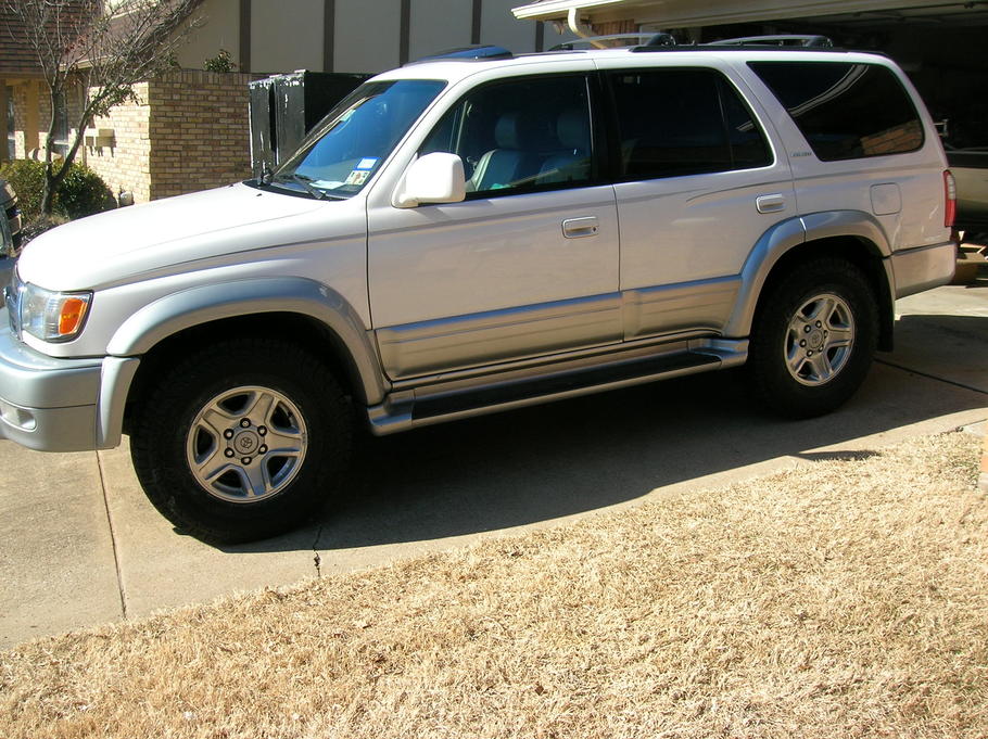

I have a 99' SR5 2wd, bone stock. Not wanting to do any suspension just change rim and tire. Any rubbing, fitment problems, etc.?

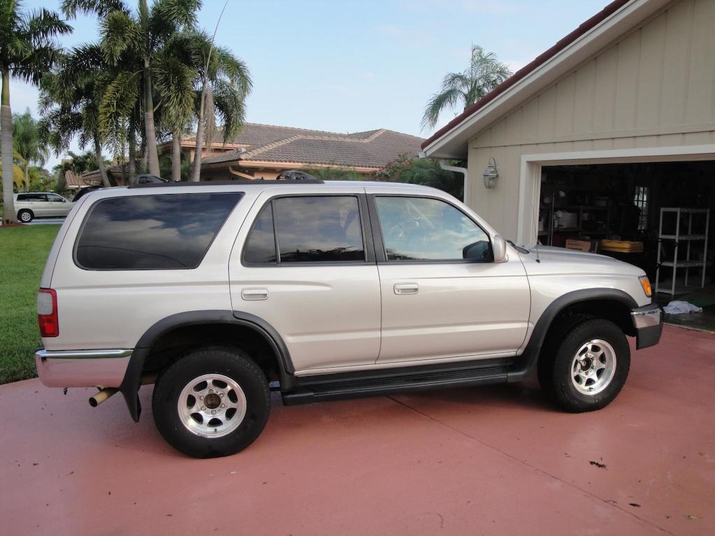

First pic is mine. Second is want i'm looking for (a great pic btw). Going A/T2 due to amount of highway travel.

I run 8069's on a '99 SR5 with 265/75/16 Geolanders. They rub the "mud flap" infront of the running boards. Getting it lifted Saturday to fix the issue.

If you look at my runner (picture in first post), those are 15" rims. It looks like i'd have plenty of room for the 16"s.
