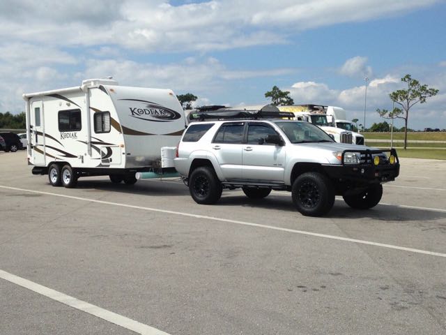

Never had an issue. This was the offset the local Discount Tire guy was running on his Tacoma. It worked well and looked good so I duplicated it.

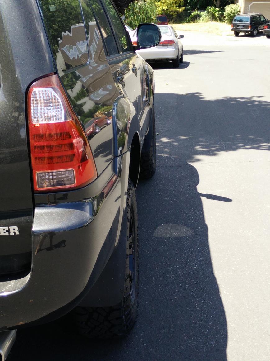

Here is a pic that might help you (tires were 285's):
ImageUploadedByTapatalk1436740002.875534.jpgImageUploadedByTapatalk1436740034.250607.jpg

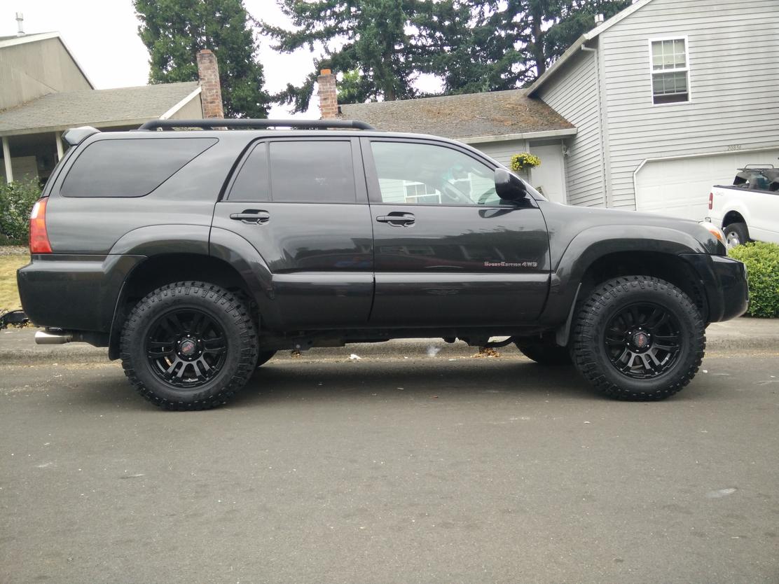

If a wheel calculator tells you they will stick out 2" further than stock they will look good. I'm running 1.25/1.5 spacers and my wheels are about flush, could use a little bit more negative offset to look great though.
I have 1.5" spacers on my stock wheels with 255/70/17 tires and I think they are perfect. When I was looking at new wheels I had calculated that -12 would be about equal or a little less offset compared to this set up.
Sorry the side view picture isn't perfect but it was the best I can find.

PS - Love the wheel design on the truck!
Rig looks good!

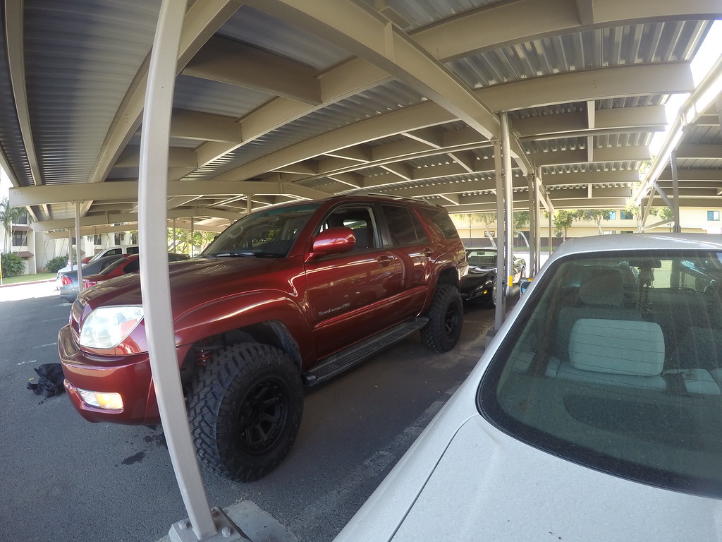

i can tell you that i have 17x9 -12 with 1.25in spidertrax spacers and it runs real agressive with my set-up which i do like!
