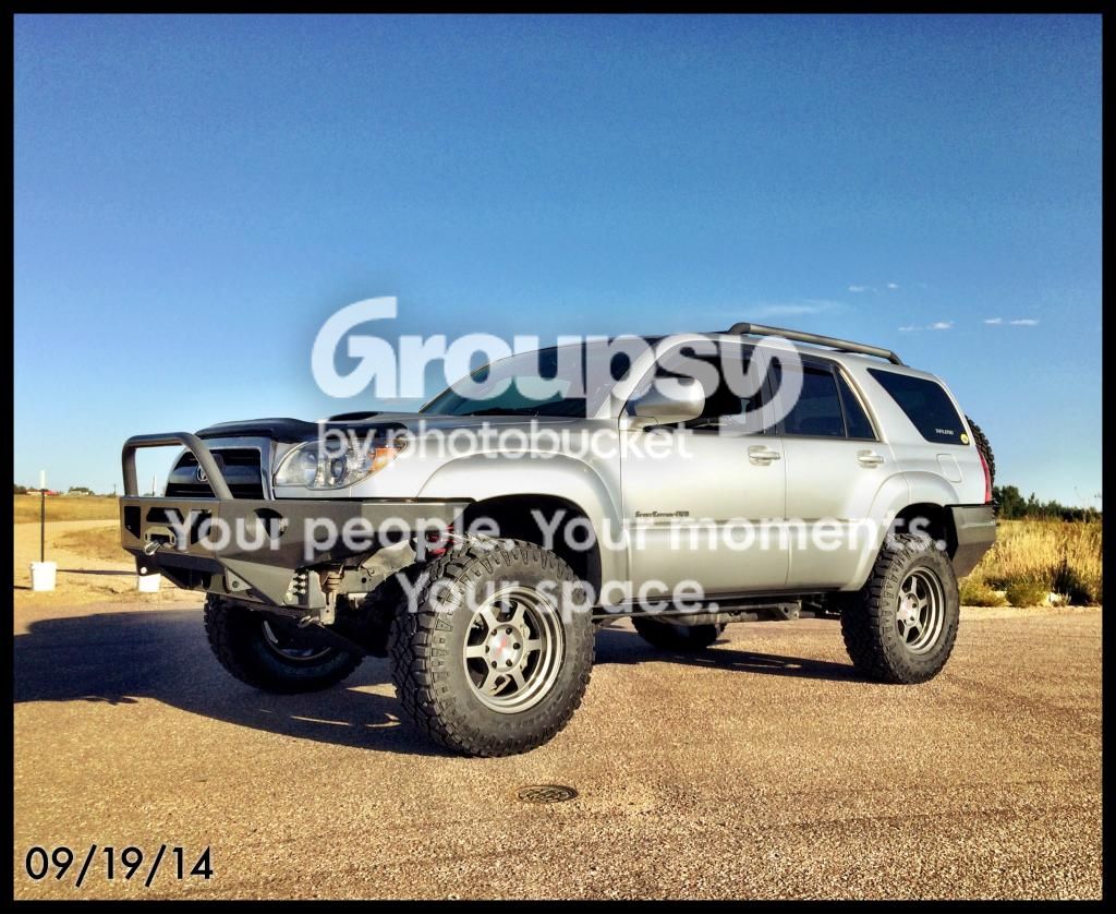

I put the Countersteer Type X wheels on my 4Runner to replace the sport rims with Spidertrax… the new wheels sit at just about the exact stance. I was interested in staying OEM as well, but went this route due to the weight savings. The Countersteer Type X with LT285/70 Duratracs weigh within a pound of the factory sport wheels, Spidertrax, and P265/70 Silent Armors.
