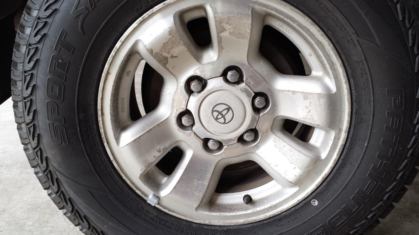

Here is what my wheels looked like:

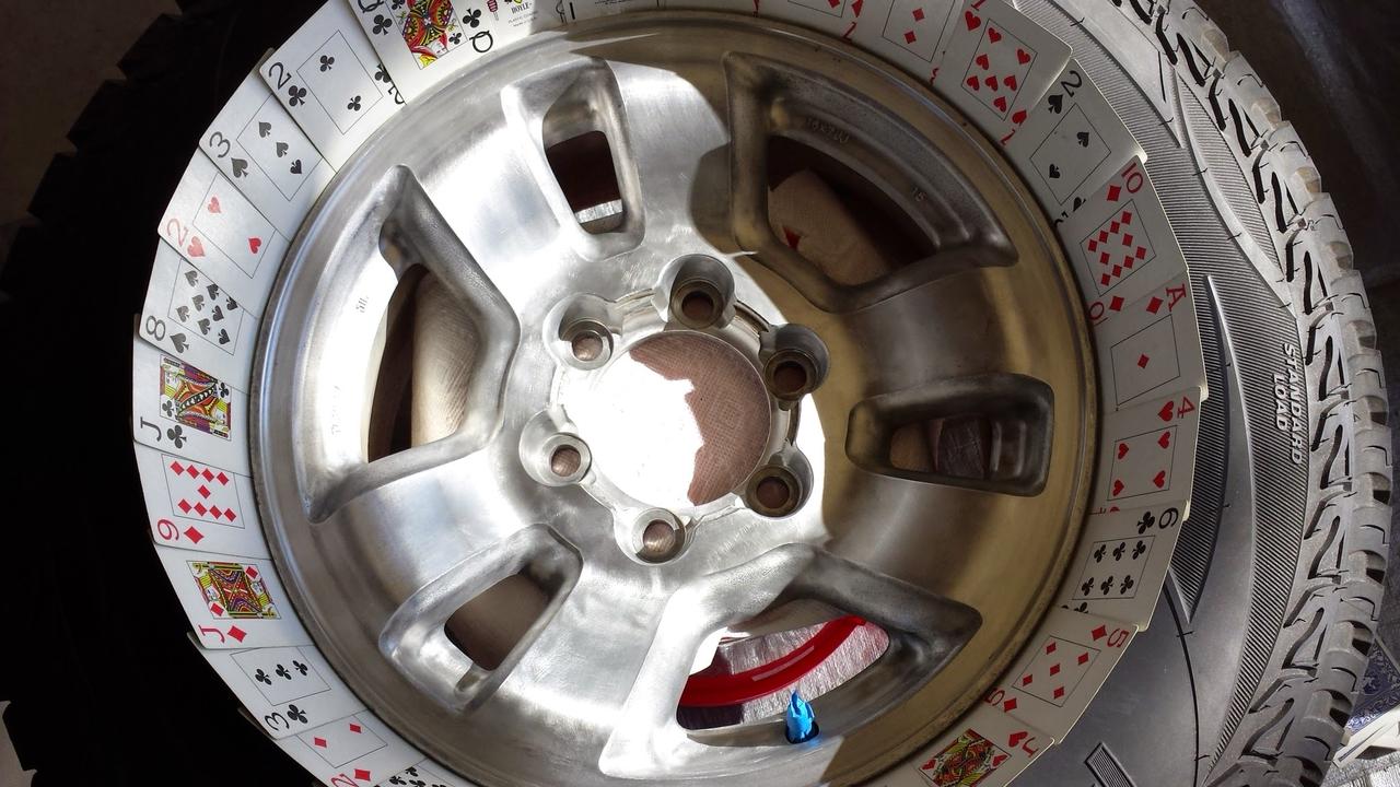

I used the wire wheels to remove as much of the old coating as possible. I then followed up with 100 grit 3M "red" sand paper to get to the spots the wire wheel couldn't. I then followed up with 320 grit to remove any deep scratches followed by some 600 grit to smooth out the surfaces. Here is what the wheels look like prior spraying:

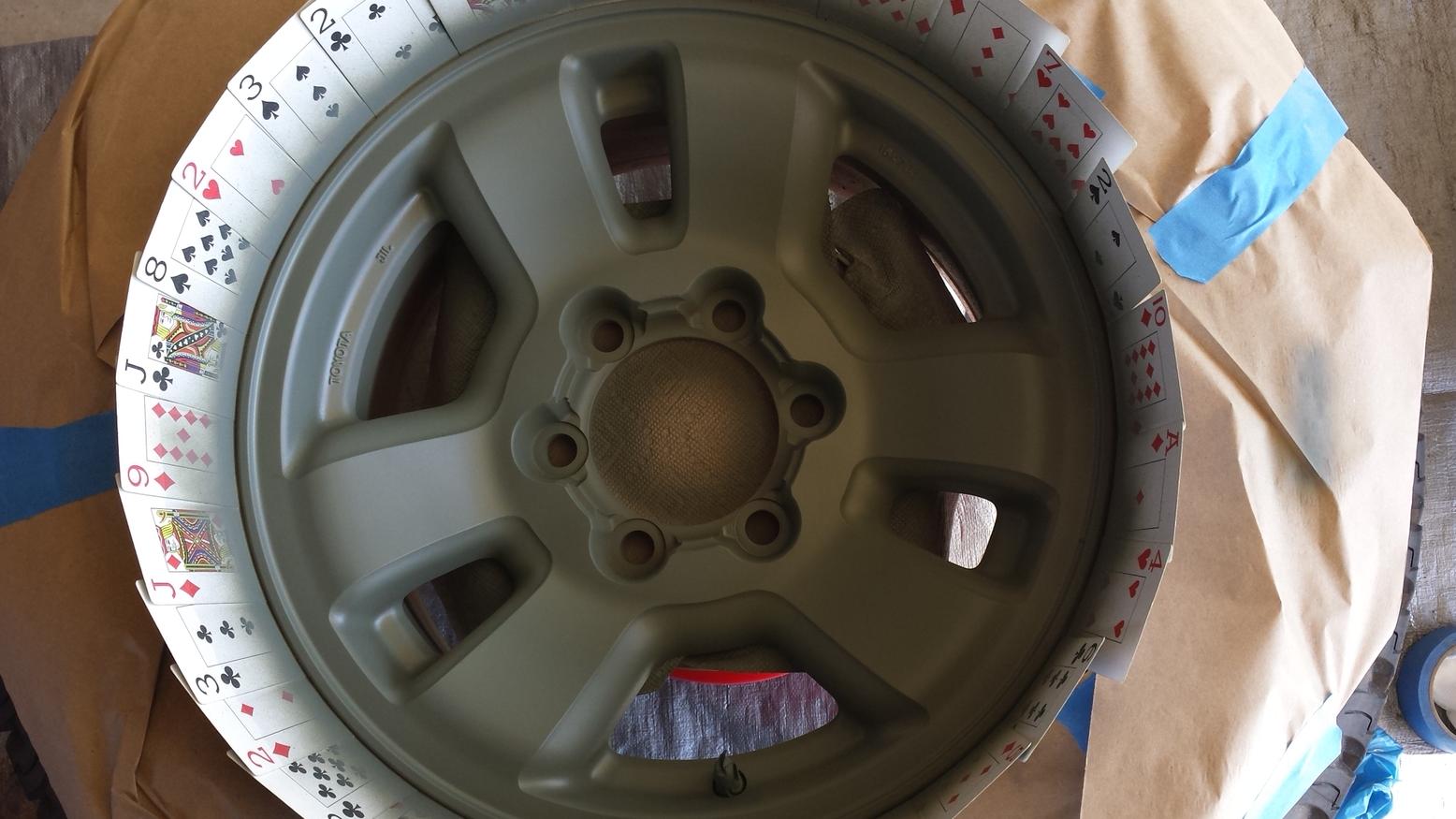

Self Etching Primer:
I sprayed one very light coat (following the dry times on the can) followed by a second heavier coat and then finally a third heavy coat.

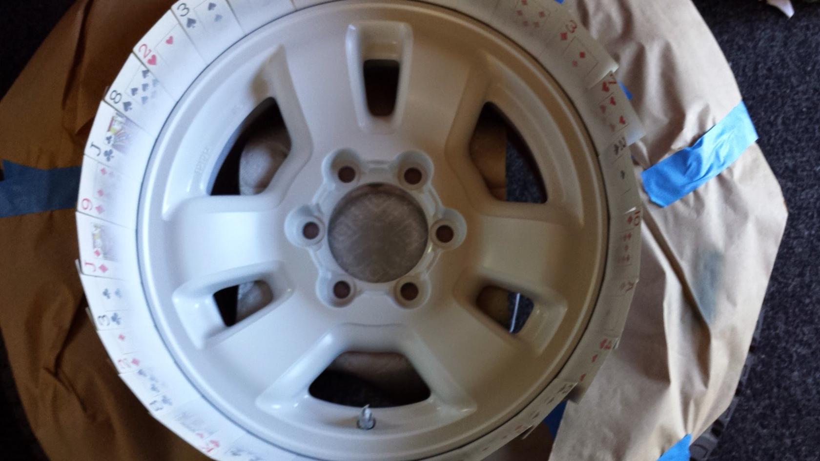

Clean Metal Primer:
I repeated the process that I did for the etching primer. Note: The clean metal primer recommends a 48 hour drying process but after speaking with a buddy of mine that does body work for a living, he said that as long as it's dry to the touch you should be fine. After all coats were applied, I waited a good 12 hours before applying the color coat.

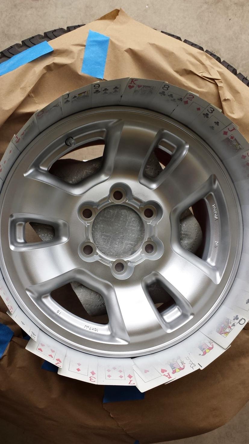

Color Coat:
Again followed the process for the other coats. I ended up applying a total of three "good" coats of color following the drying times on the can.

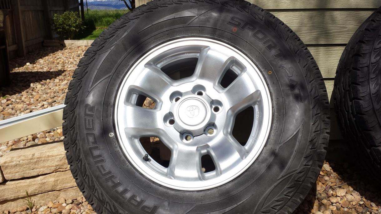

Clear Coat:
For the clear coat I applied 4 good coats as this is the protecting layer for the color.

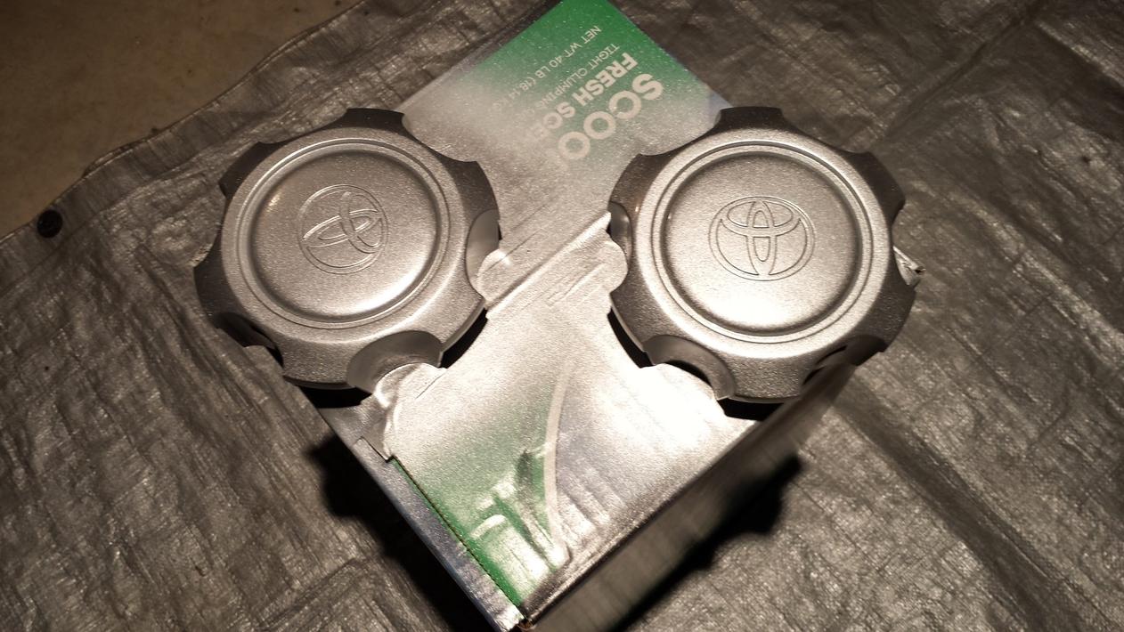

Center caps:
I sanded down the center caps with 320 and 600 grit sand paper. I used the same primer and paint that I used on the wheels. The primer doesn't say "plastic" like the paint does but I wasn't going to go buy another can of primer.
I want to thank 496_BB for his write up. I'm very pleased with how they turned out. I don't know longevity as I just finished.
