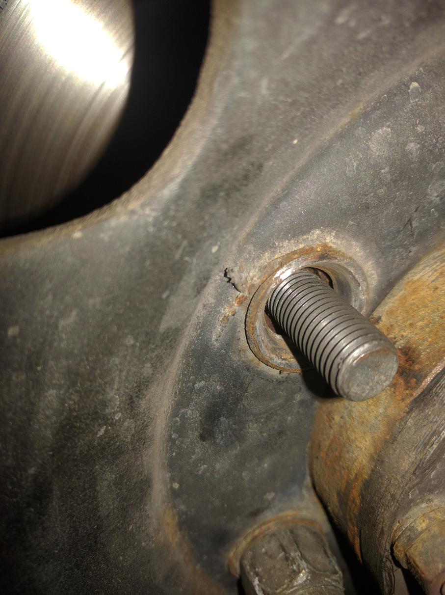

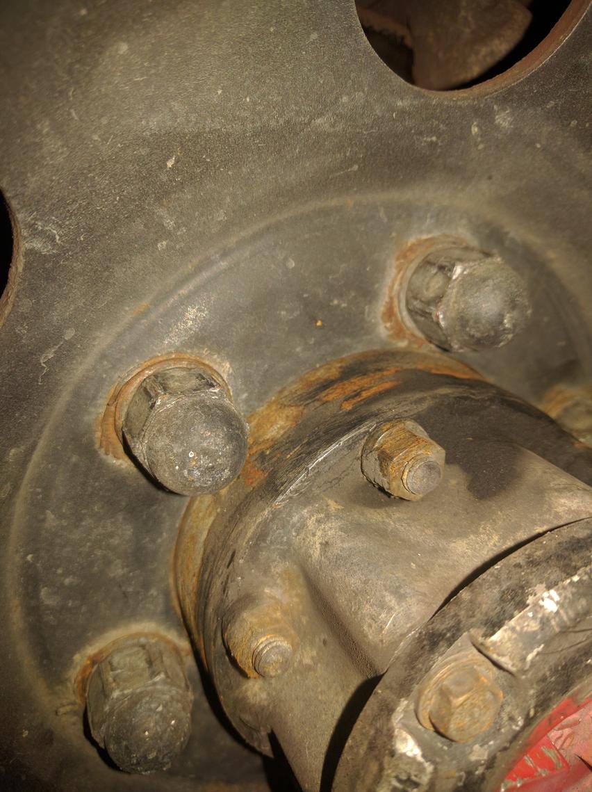

I went to discount tire the other day to have my wheels balanced, I have the front end shakes at highway speeds and there are no wheel weights on any of my wheels, so I assume that is why.
anyway, (after waiting 45 min) they pulled my first wheel off, and the guy brought out one of the washers, said it was broken off from the wheel and too rusty to work on.
1. Aren't those washers normally separate? Guy is off his rocker?
2. All I saw was a bit of surface rust I can clean off with a wire brush, how much rust is too much?
Do you have any pictures? There aren't usually any washers involved with wheels and lug nuts. Some pics might help but does sound fishy...
Went out and took some pics, i guess upon inspection it looks worse than i remember it looking when i checked out my brakes
You can see the conical bits, which i assumed were washers but are not all loose, so maybe they are supposed to be attached?

Can't help you with the question as to whether these are attached or not. Did it appear attached by looking at the the wheel and the broken piece(es)? I know they sell conical washers for wheels.
someone overtightened your lug nuts a lot. I`d replace them all , new set at discount tire is like $20. is that what they try to sell you?

I've always had good experiences with them as well, which is why I frequent them. When he came out with what I assumed was a conical washer, and told me it was a broken part of my wheel, and immediately asked me if he could show me some new rims, I got suspicious though.
Guess it looks like he might have been right, either those are rusted on pretty bad, or supposed to be attached and falling off :(
Oh well, time for new rims!:D
I have never seen anything like that. Plenty of toyota wheels out there though, you can probably find a set without buying them at discount tire.

those aren't washers, they are the lug nut seat. part of the wheel.
like you said, time for new wheels.
Yea those are suppose to be part of the wheel. Ive only seen that kind of style on steel wheels, but definitely should not be coming off. There are places that you can have it repaired but honestly I think its time for a new set of wheels. Also Ive always had good experiences with discount tire aswell. Guy might have been showing you some new wheels as sorta a safety precaution.
