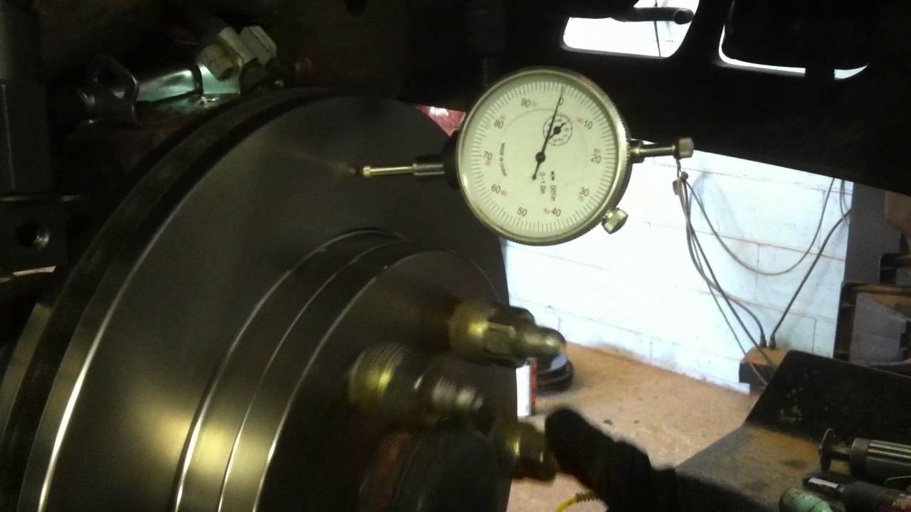

Please explain what "run out" means. I am not a brake mech, and the term baffles me.
@nevada
its just how much deflection there is. in extreme cases, you could call it wobble.
when using a solid point, and then when turning the rotor, its the measure of total deflection from that point. the total movement, both towards, and away.
the dial indicator pictured being that solid point. as you turn the rotor, the needle will move. the run-out will be the total of that movement.
Perfect.... and with pictures no less. Thanks.
So, how is run out expressed? In mm + and - ?
What are some examples of average and extreme?
Perhaps you can tell I'm prepping for a discussion with my SM.
