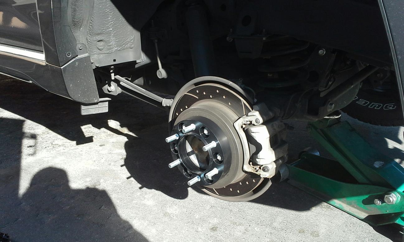

Easy as balls. No alignment needed. Go with Spidertrax 1.25" adapters, period. I used them on my '03 Tundra and they were great. My tips:
- Clean the hub surface with a light sandpaper scuff, then alcohol wipe down and a quick blow of compressed air on the hub and studs.
- Offer up the spacer to the hub so you can see how it is oriented and just get a feel for it.
- Securing to the hub and use of Loctite: this has been debated, but Spidertrax includes a tube of Red with each set. I used just a dab to be on the safe side. I had no issues removing with a tire iron.
- Be very certain to secure the supplied nuts to the spacer in a star pattern. And don't tighten one all the way, then start on the other. Think of doing it in a few torque increments...perhaps 40 to 60 to your final spec of 90 ft lbs (or thereabouts, I forget their exact recommendation). You want as evenly spread out torque as possible.
- Offer up the wheel to the spacer as you would normally to a hub. Then follow suit as above with the wheel with regard to tightening your wheel lugs to the adapter
- Job done, I ran them for 10,000 miles with zero issues.

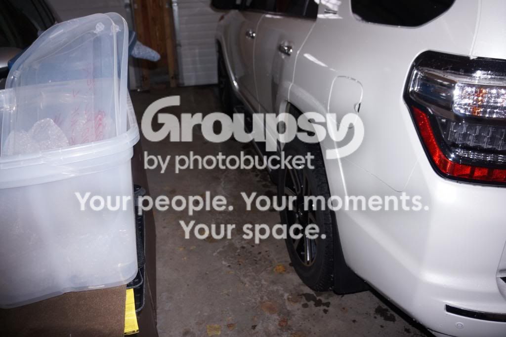

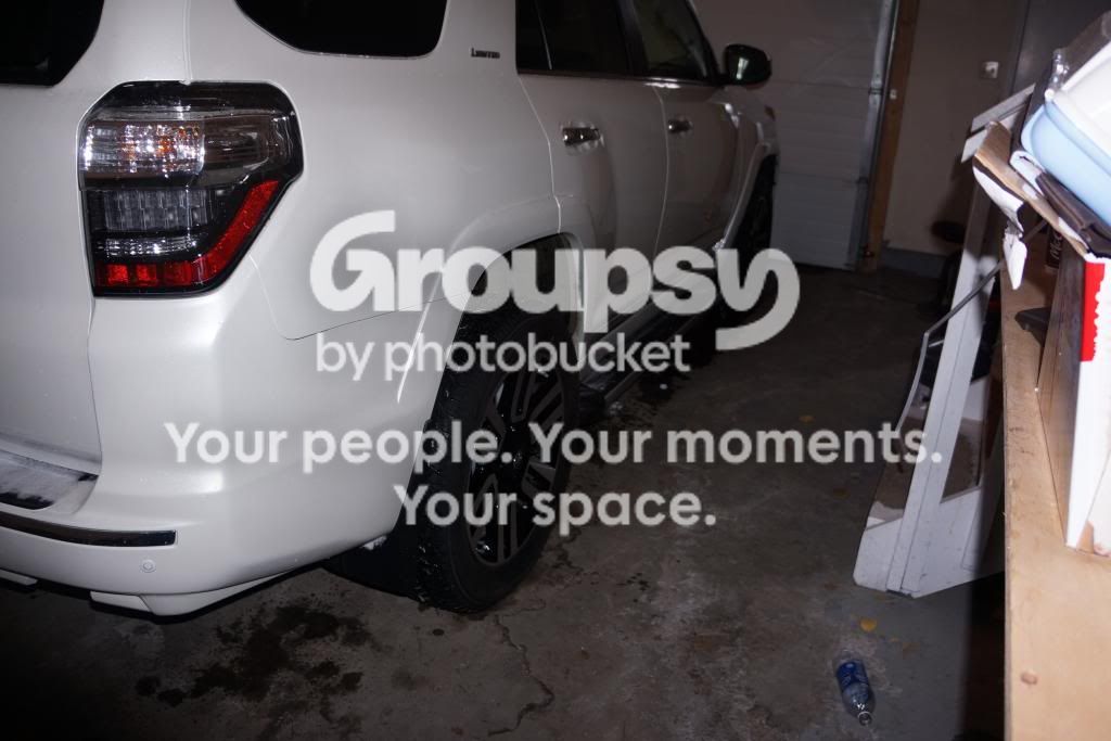

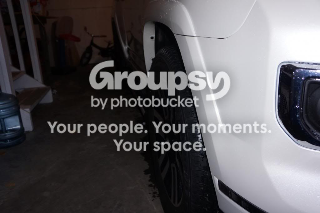

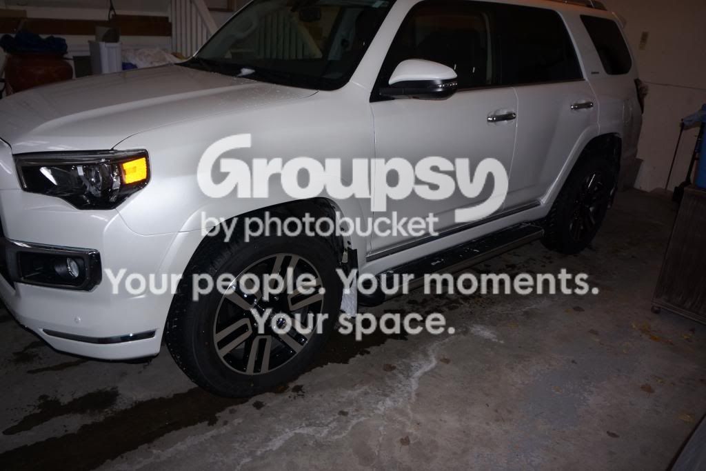

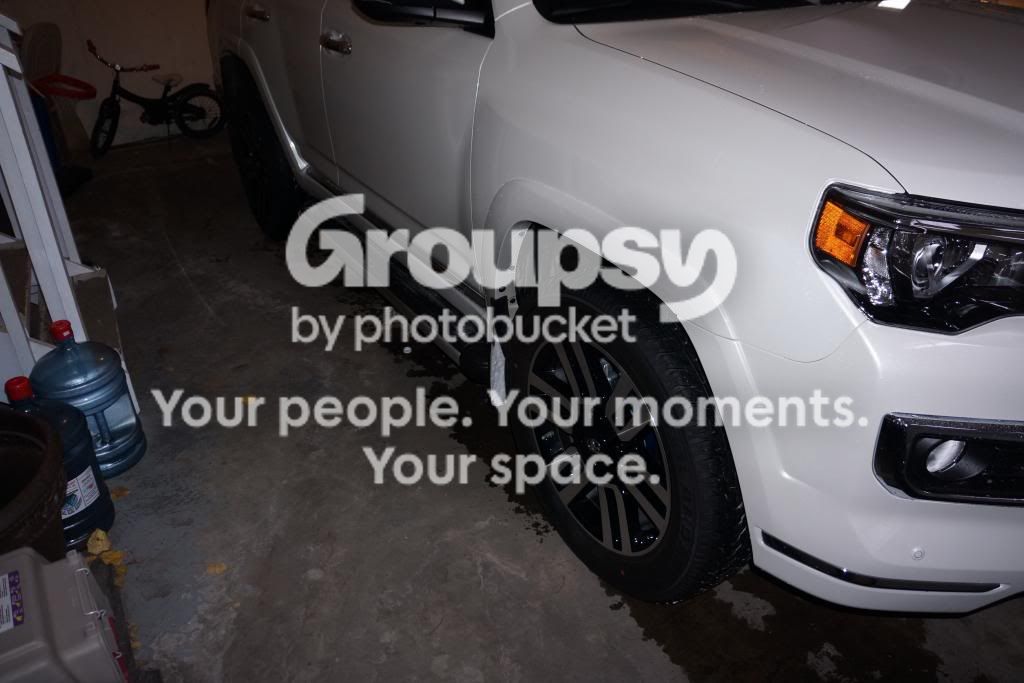

Not the best pictures but here is mine with stock limited wheels and 1.25 spidertraxx. No lift.
DSC02593_zps11e11da7.jpg~original
DSC02592_zps73127833.jpg~original
DSC02591_zps3393a959.jpg~original
DSC02590_zps9c862ea6.jpg~original
DSC02589_zpsfad6056b.jpg~original

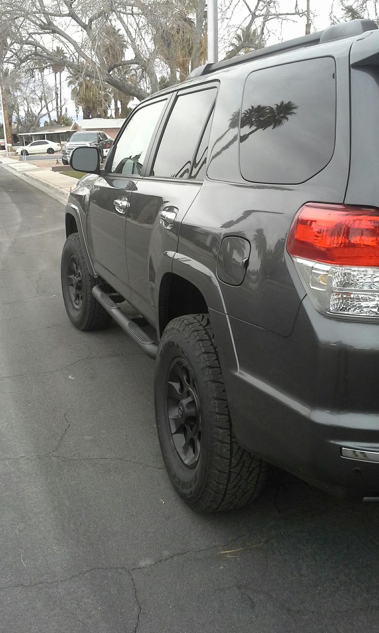

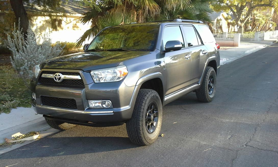

Stock size tires but 1" wider wheels (17x8).
Before spacer.
After 1.25 spacer.
I did have too do the front fender mod and trim part of the mudflap. Both were very simple fixes and done with household tools. And the side of your 4R will see more road spatter.
Any way we can get better pics? maybe outside from a distance, I got a 15 LE and have been thinking about adding these, I added them to my Rubicon a few years ago with no problems. I just like to see them with OEM Tires, thanks. Oh ya you miss that S4 yet? I sold my 2007 B7 S4 a few years ago and just picked up another one in real nice condition/ one owner on the cheap. I wanted a RS4 but still waiting for the prices to go down a bit more.
Yeah i'll try and get some better pictures. I do miss the S4 but not as much as I thought, I fell out of love with it as soon as I saw the new BMW M3/4's.
