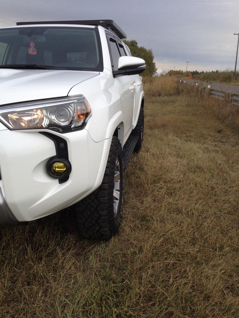

2014 TE with stock wheels and 1.25" Spidertraxx spacers and 265/70/17 Duratracs..love it

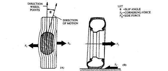

Roger. But for any Lateral CG type calculations, the "Lever's hinge point" would need to reference the outer edge of the contact patch/track width, correct? (minus whatever sidewall flex/deformities exist at said conditions).
:cool:
:cool:
If your tire was solid that would be correct. Here's a pic:
So basically yes?
With our rather skinny tires (height:width), I could see this sidewall deformity approaching the center-line of the wheel in evasive maneuvers. With anything much wider (like a 285 or 295), you'd be hard pressed to get enough sidewall flex to meet the center-line of the wheel for the lever/pivot part of the calculation - but I'm an audio/broadcast guy, not a suspension engineer :) (I'm sure it shows :p ).
