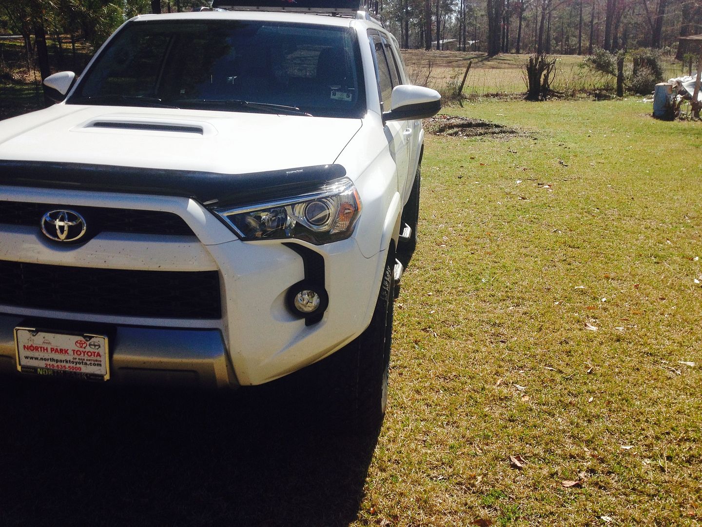

I kept the stock rims when I leveled the front with Bilsteins and put on OEM sized Michelin m/s2's. I like everything about it and the look from a profile view but not really happy with the stance from front and rear. I have never used wheel spacers before and am not really sure how easy/hard they are to install or what is the right kind/size, etc. for what I want. I am not looking for the tires to stick out past the fenders - just a visible wider stance. It's a daily driver that sees a little snow now and then but that's about it.

The build thread posted above was nice to look at and I may be looking for a needle in a haystack because I suspect most that bother with wheel spacers are probably also doing bigger tires and/or lifts. But I'd really like to see pix of a SR5 with stock wheels and stock sized tires with the spacers installed.
I just went out and washed it up good after all of the salt and mud from the ski resort. I'm not seeing anything obvious that looks like a potential rub if I put the spacers on with the tires I have. My only hesitation is that, without bigger/wider tires vs. stock, the stance may look strange in the opposite direction. Hard to tell.
