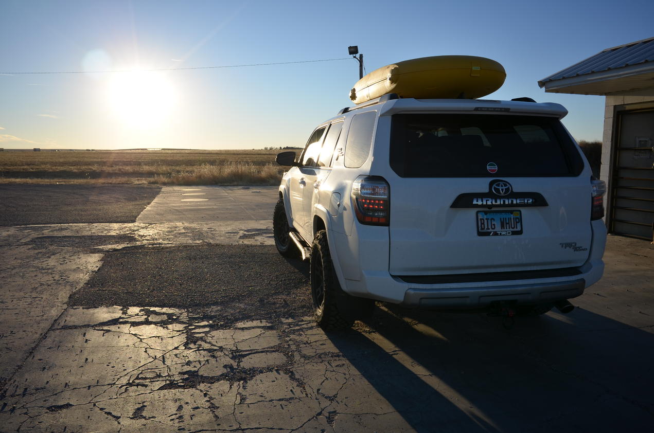

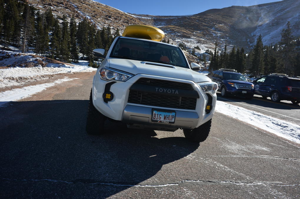

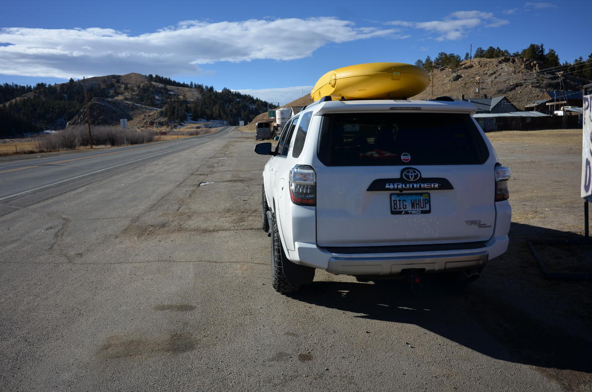

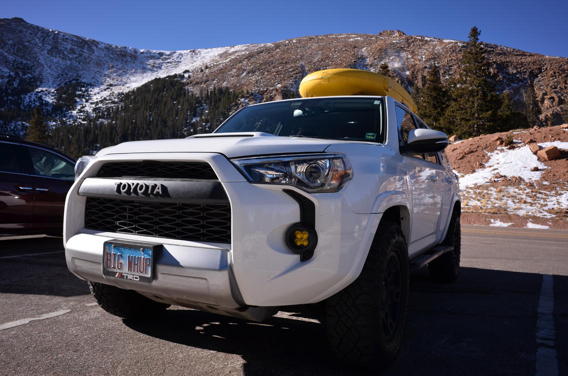

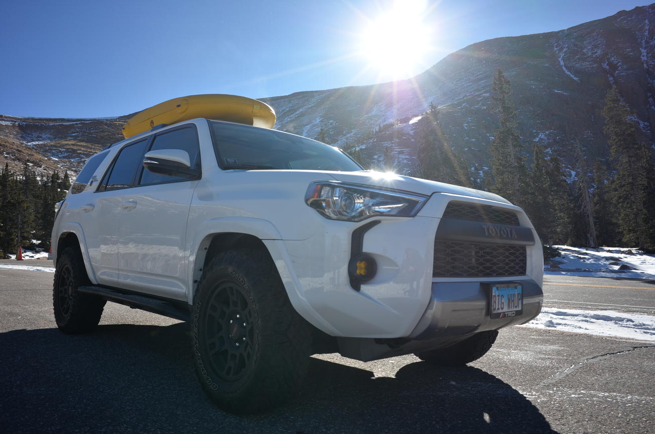

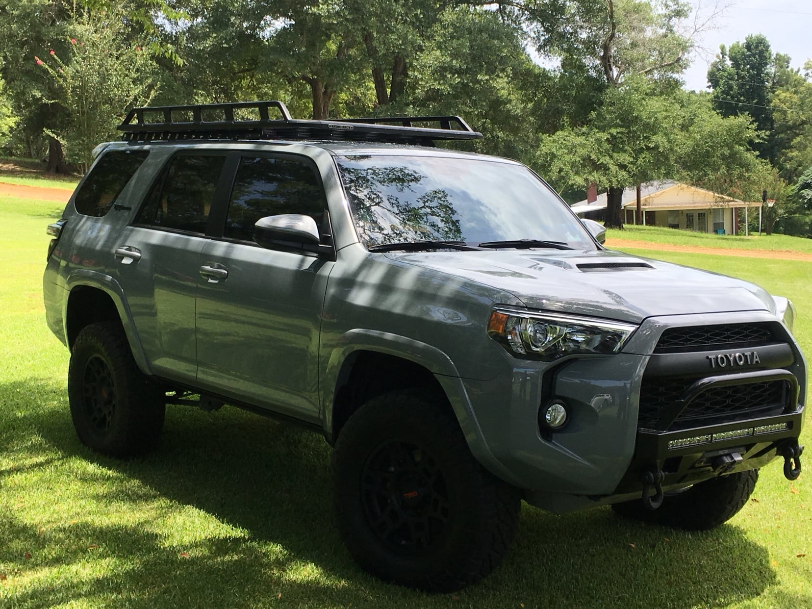

Here is what 1.25" spacers look like on the 7" TRD Pro wheels with 265 70R17 Duratracs with no lift on an ORP. They fill out the wheel wells more and IMO look better with the C4 fab sliders. All mods in stages for me, and this is the running configuration of my rig before I spec and budget a lift and new wheels/wider tires.
At what cost you say? I had to trim the front bumper and relocate the liner and pull off the front mud flaps. I don't have the 55mph wiggle with the BORAs torqued to 90 ft lbs with blue loctite and maybe if you keep your tire pressures equal and check the torque on the spacers occasionally all will be fine with your ride as well. I don't see enough posts/classifieds/threads about folks buying used 4Runners or other 4WD vehicles and replacing the bearings due to spacers, so I'm not going to worry about it for the short duration that I plan to run this setup.
Why do it? Makes the truck look much beefier than without. We get compliments on the overall setup everywhere we go. YMMV.

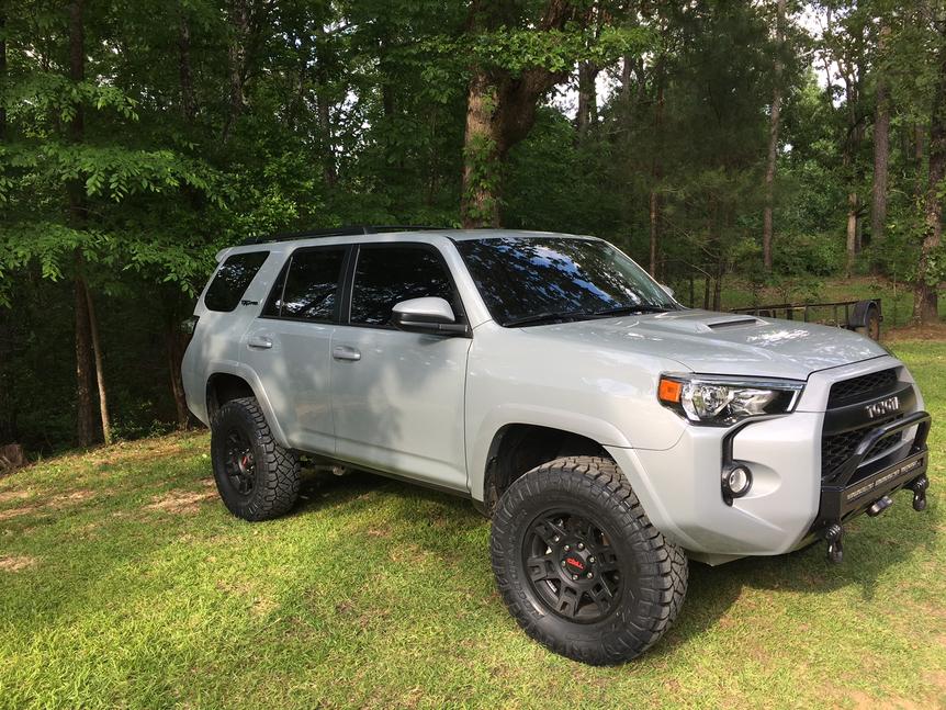

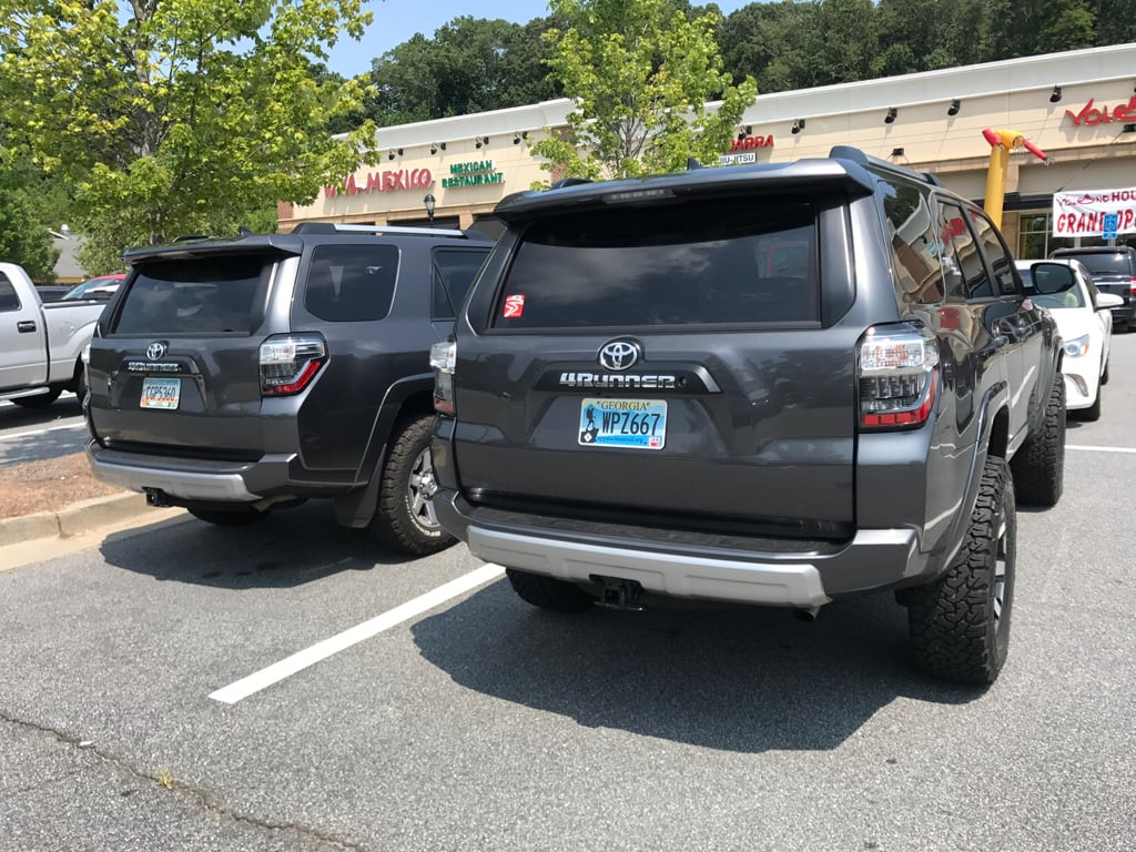

Mine on the right with 2.5" lift, 285s KO2, and 1.75" BORA spacers on stock TRD OR wheels compared to stock height KO2 265s on the left.
1.25” Spidertrax on stock wheels.
17x9 -38 aftermarket wheels.
