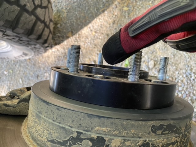

I’ll double check the size, pretty sure these are 1.25, showing rear wheel studs. Note the protrusion.

Uh oh
That looks like a problem. Well... Hmmmm... they'll be here today or tomorrow so we'll know. My assumption is that with that protrusion it's a no-go. Can't fit the wheel flush. I suppose I could cut down the bolt but it would be hard to do without buggering the threads, and probably not super smart anyway.
If I get that issue they'll have to go back.

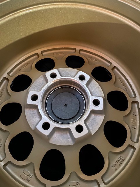

Check the back side of your wheels. Some have relief cuts that will clear the studs
Thanks for the pic, tried to explain that in my first post.
Some wheels won’t work though, I know for a fact my stock FJC steelies won’t fit cause their mounting surface is nearly flat, the wheel would torque against the end of the factory studs and not on the spacer itself.
I had to hand file down each rear stud in order to run Trail/TRD ORP wheels with 1" BORA spacers. The Trail/TRD ORP wheels do not have a relief in the back.
