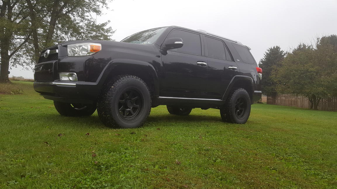

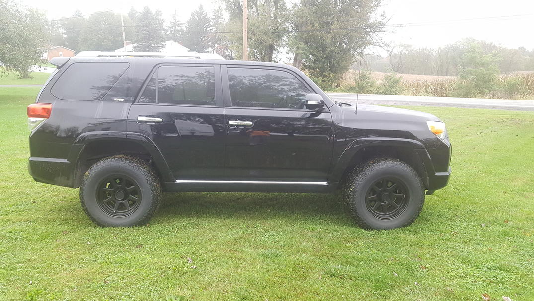

I just installed the wheelers springs on my 4r and I got 2" of lift in the rear. The truck still has a fair amount of rake. I have the bilsteins set at zero in the front. The ride is significantly better with less body roll and a firmer, more responsive feel. I'm running 285/70/17 dynapro atm and they did rub until I moved the inner fender liner forward.

Stock front springs with the bilsteins?
Which rear springs? Had to of been T12.
