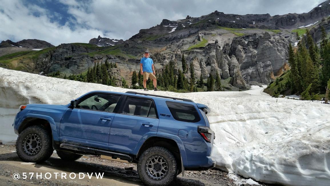

I have an '18 Pro, with the front half of the Pro specific lift from Toytec up front, and the T13 springs in the rear with the 10mm spacer on the driver's side. Mine sits only ~1/2" higher in the rear with that setup.
I've had it loaded down with a buddy and our gear for a week long trip, and seen no difference in ride height.
I've got 23" from the center of the front wheel hub to the center of the fender opening above it in front, and 23.5" at the same spots in the rear.
Very happy with the ride and performance, even after adding a steel SSO slimline bumper and winch.

@57HotrodWV Whats the net gain for lift in the front with that set up? I believe the Toytec is a 2", but without swapping springs, I'm sure the SSO bumper and winch eats up some of that? I'm swapping to 14x650's so I get the full 2" of lift.
I'll also be adding SSO Bumper/Winch, sliders and rack, plus I have racks in the back end and other gear as well.
The front portion of the Toytec adds ~1.75" up front. It includes a set of thicker lower spring perches, which increases pre-load on the springs, and that provides 1" of lift. Surprisingly, I didn't lose any lift when adding the bumper and winch. There is a good chunk of weight lost when some of the stock bumper parts are removed to add the SSO bumper.
I've got Shrockworks sliders, and full armor as well.
Now I'm even more concerned about the T12 vs the T13 I the rear, and ending up extremely raked down. If I get 2in up front for the 14" springs, I was hoping for 2in from the T12s, but if it's closer to 3in, it will looks really off.
Finally had a chance to get some photos up:
Bilstein 5100s all around, front at 0
Wheeler's T1 front with 1/4" spacer driver's side (approx 2.5")
Wheeler's T13 rear with 10mm OME trim packer driver's side (approx 1.5")
Factory UCAs (aligned perfectly)
Toyota TRD Pro wheels
Firestone Destination A/T 285/70 17 (33")
