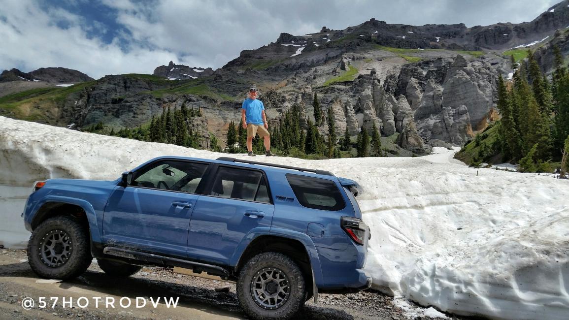

I put a single, 10mm trim pack on the driver side of my '18 Pro that has T13s on the rear. I've got the front half of the ToyTec Pro lift up front.
With 285/70 tires, my fender lip over the center of the front wheel is at 38", and 38.25" at the same spot in the rear.
