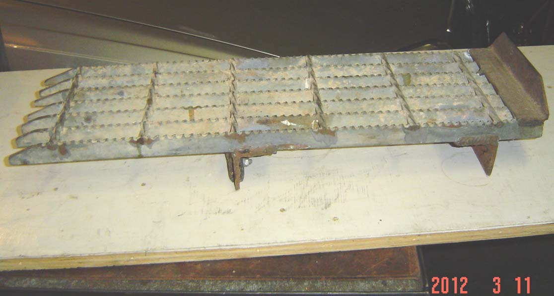

1. I have a Low Work Ramp 3” high that eliminates a floor jack and stands (that I should have made 4-5” high. LOL

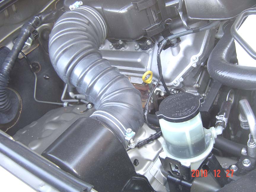

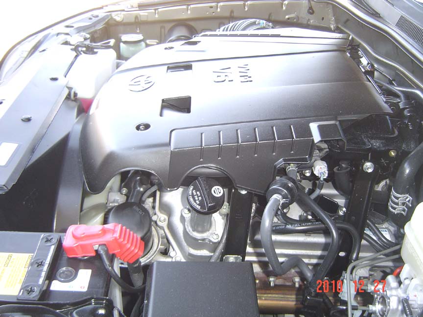

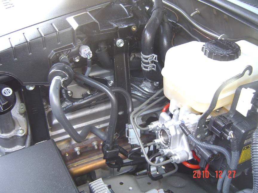

2. When I change my oil, I spot check fluid levels, belts under the hood and look for any signs of leaks underneath. Changing the oil filter is a dream by the battery’s post red insulation.

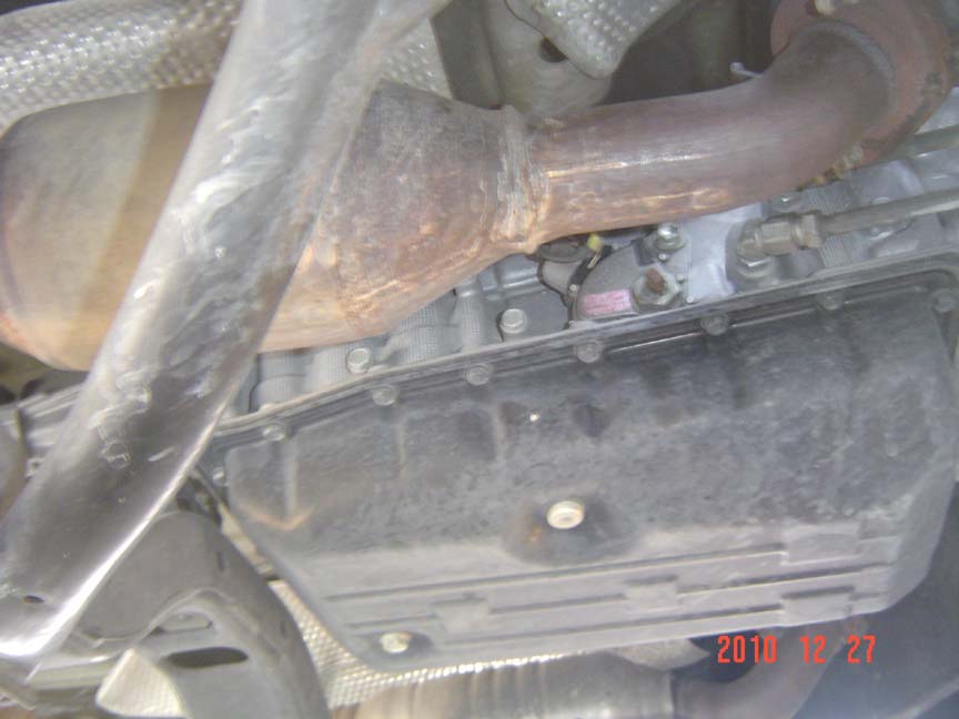

3. The trans pan’s drain plug? caught my eye since the plug is not at the bottom but changes are not recc. I feel it’s to drain enough fluid w/o making a mess if needed. Nor is there a dip/stick fill/check tube.

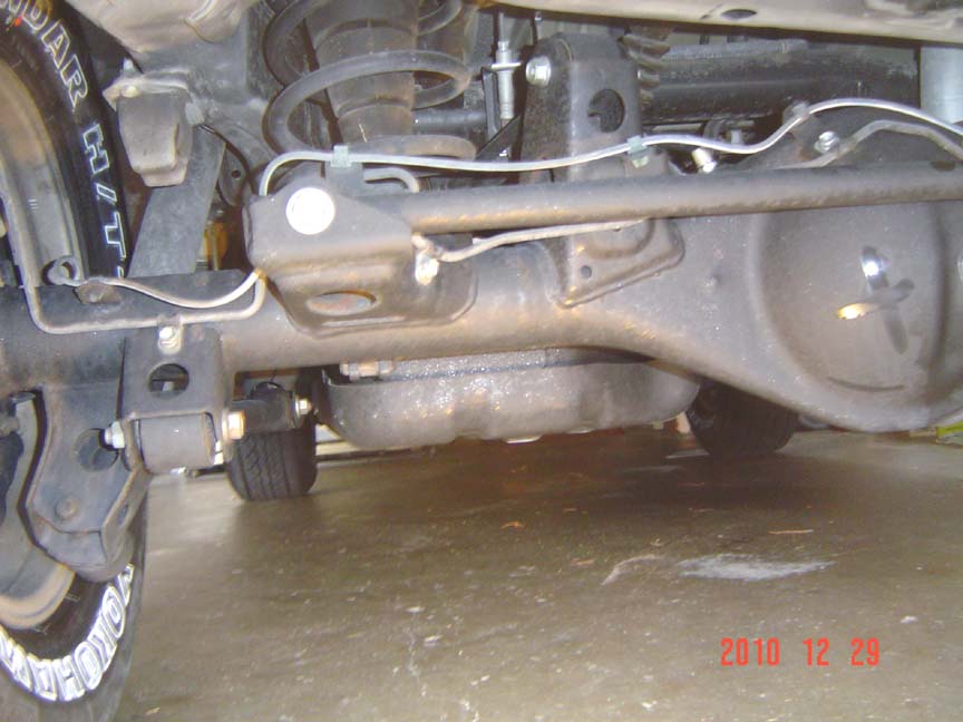

4. Checking the rear-end’s fluid was a challenge. The one-way vent valve ck was good, d/n take it apart.
