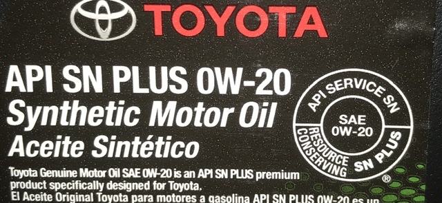

the other issue I had was we all have fuel direct injection engines. well NOW we must use the SN plus engine oil spec... this got approved in may 2018 because manufactures had many of these engines damaged because of the direct fuel injection.
read the back of the oil bottle for SN PLUS not just SN....have fun

because I did change to SN PLUS the runner is very quiet on cold starts.
moly keeps it quiet no ticking on any cold start. 800PPM moly.
The Toyota 0W-20 Synthetic is labeled as API SN and SN PLUS. I presume this is what you used.
