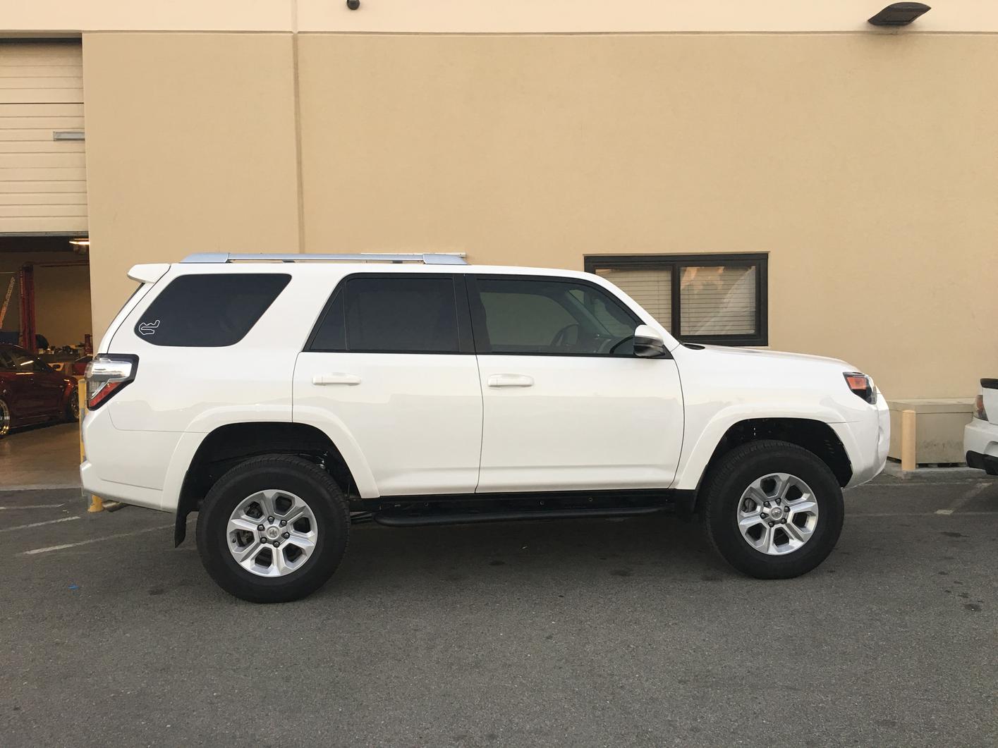

This is the results on my 6112/5160 install. Thanks to all of you for the help. It does sit quite a bit higher in the rear than what I was expecting and I hope it does go down a bit.
-6112 at the middle setting (3rd notch)
-wheelers t12 rear spring
-Airlift 1000 with 5psi
-Bumpstop has one extra segment that was not removed.
-3rd row seats and sliders are the only weight adders
With the taller spring I was thinking with the airlift bag being designed for a stock height spring it would make sense to compensate by leaving an extra segment of the stock bumpstop.
At 5psi the airbag doesn't push much on the bumpstop so I don't think it's causing the extra height but maybe I'm wrong.
