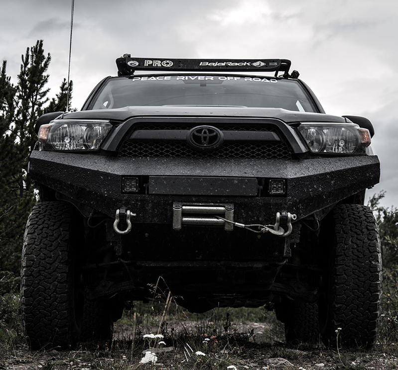

I'm going to try and make this short:
Running OME coils and shocks. Heavy up front, mediums rear.
Been on for a couple years now.
I have some weight up front - steel bumper and winch (about 250 lbs combined).
Current center hub to fender height is 21.75" (almost stock I believe?)
I was parked beside a stock 5th gen and it was almost the same height as me, same with stock Jeeps. I know it's due to the weight and previous abuse. Time to upgrade...
Would the BP-51's bring the front end up some? I almost miss not carrying all the weight around with me, but it's necessary for the trips I do.
