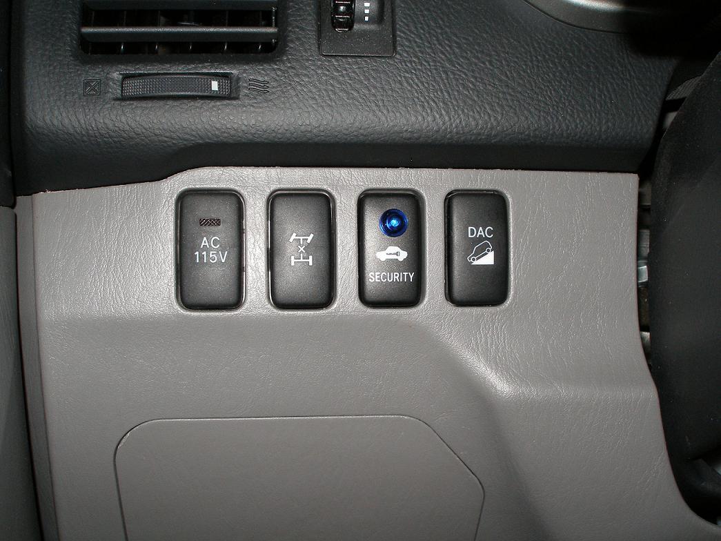

Hey guys. I have been trying to figure out a good place to install my aftermarket alarm LED, which wasn't going to be your normal center console blank install. Of course, that is a good place because it's able to be seen from both sides of the vehicle. But again, I wanted it to be somewhat original, and different.
I wound up getting a Highlander security indicator, gutted it, then placed my Viper LED in it. Another thing I was thinking about doing is installing the indicator LED in the overhead console, kinda like the BMWs have (except I believe theirs is mounted on the underside of the rear-view mirror).
Anyway, your thoughts?

I think it's good sometimes to get others' opinions. Keeping in mind what may look good to one, may look stupid to someone else :D
