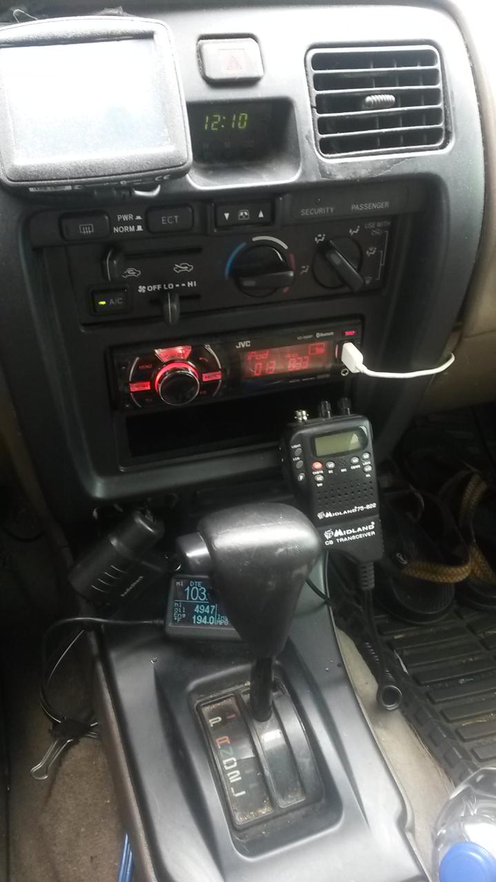

Here is mine...Just a handheld unit that I slide the clip under the cubby thing under the radio.
