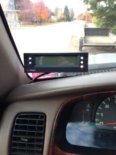

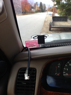

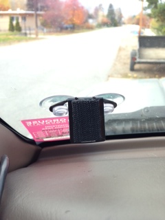

Another Option for Mounting
There really doesn't seem to be a "perfect spot" to mount this thing but here's what I did. It may not be heavy-duty enough for wheeling (I'm not sure).
I just put it in to monitor trans temps as I've been doing some towing lately and want to know if I should get a trans cooler.
Also considering by-passing the radiator (to avoid the milkshake alltogether)but I'm still on the fence. I'm gong to replace the rad first and monitor temps, then probably by-pass with B&M and monitor temps. If the trans temps are too low in the winter- I'll change it to in-line.
That's the plan!
Anyway, here's my simple mount.
I used the little windshield mount from my escort radar detector (I use a visor clip for the radar).
Here's a link to the mount Windshield Mount with Suction Cups - Radar Detectors | Laser Detectors | Radar & Laser Experts ESCORT Radar
Cheers

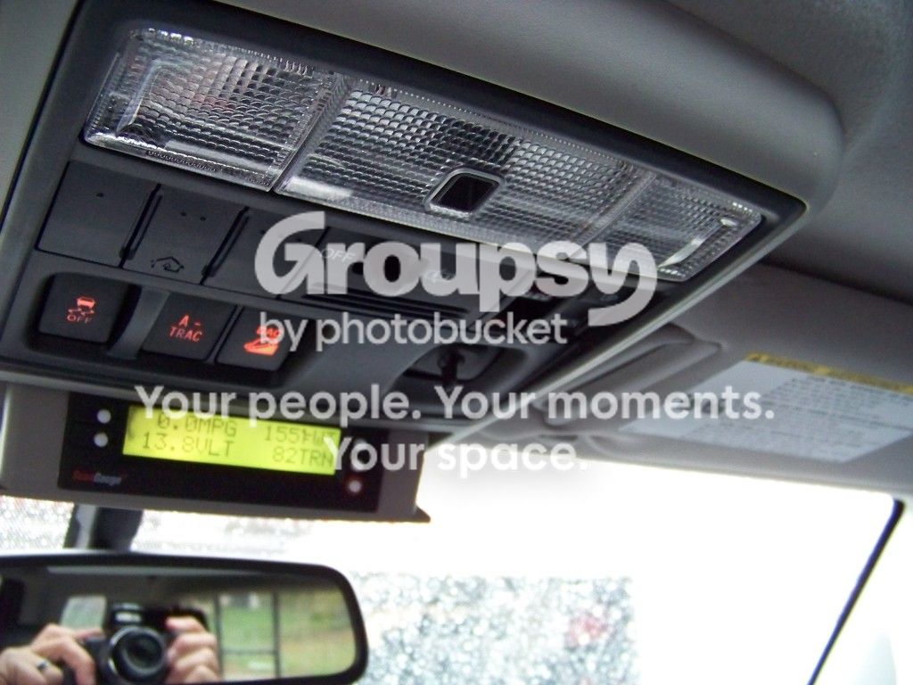

Man that looks great! I was thinking of doing something similar. I never use that anyway!
That was my thought. Unless you wear Aviators, most Oakley's and similar glasses won't fit in the sunglass spot on our overhead console. I'm sure you could rig it up with a little ingenuity.

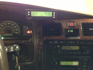

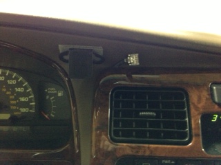

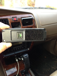

Moved it!
Quick update for others considering mounting options in 3rd gens. I wasn't happy with it mounted to the windshield:(
I re-used the escort radar windshield mount (without the suction cups). I velcro'd the mount to the dash and ran the cable behind the vent down to the plug (completely hidden- which is why I'm posting this)- lots of guys have mounted it in this position but with the cord hanging out! I found a thread by CO Flyfisher (3rd gen dash clock fix http://www.toyota-4runner.org/3rd-gen-t4rs/67508-3rd-gen-dash-clock-fix.html) that showed how simple it is to remove the center console trim. I'd say this looks a lot better than having the cord running down on the outside!
Here's a couple pics. Hope this helps someone:)

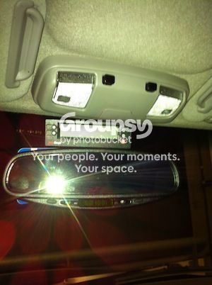

Anyone just use the scangauge mounting kit (not the blendmount kit)?
You mean the blendmount scangauge mounting kit? If so, I installed one on my 1st gen Taco in combination with my Cipa 36500 (auto dimmer/temp/compass/bottom pointing driver/passenger maplights) rearview mirror and love it! Just fyi, the mounting kit will NOT mount to the neck of an existing 3rd gen 4Runner OEM rear view mirror. You will need an aftermarket mirror that has a round neck like the Cipa or Gentex and epoxy a mounting button to the windshield, a little DIY work but worth it IMHO.

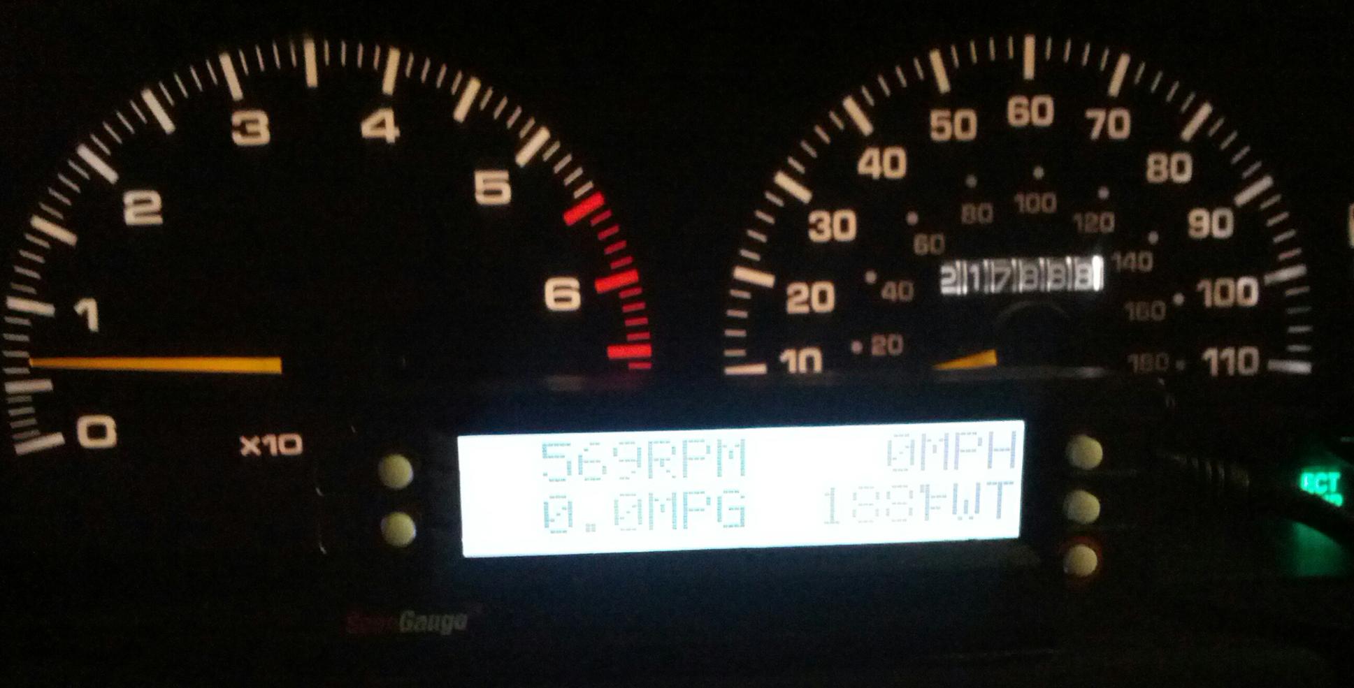

OK so I finally installed the SC2 I got for my birthday and I think its pretty awesome.
One question though .... Why is mine reading F Coolant Temp (usually 190 in town) since I thought my 97 Limited didn't have a valid AT temp sensor/? Is it reading something else?
