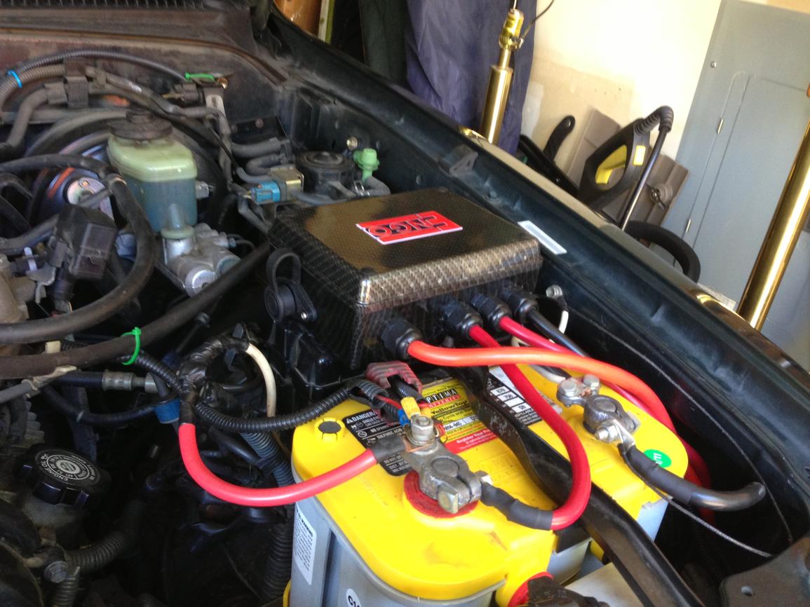

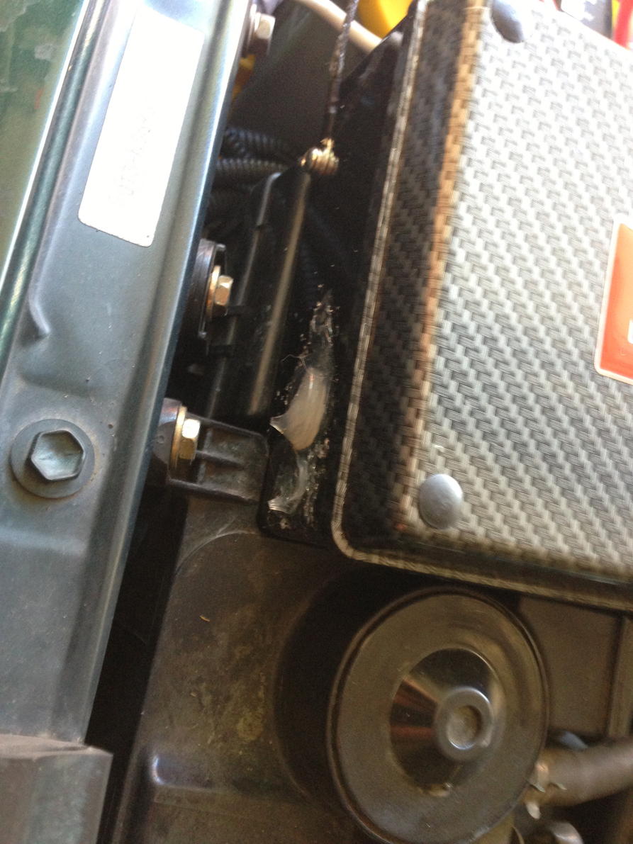

Put mine on top of fuse box next to battery. It was a tad too big for the top of the bumper and it actually fit perfectly, nudged between battery clamp and evap box. I did have to move the wired control connector to oposite side and installed a wireless module so i dont have to open the hood to use it. By switching the wires around, all i had to do was get 1 harbor freight 2 ga. inverter cable set (6') on sale for just $30.
All that said the 6' cables barely reached, and depending on the size of your box (lol) this location may or may not work out as well.
I would say wait until you have the box in hand and then just mock up all the places that might work and go from there.
