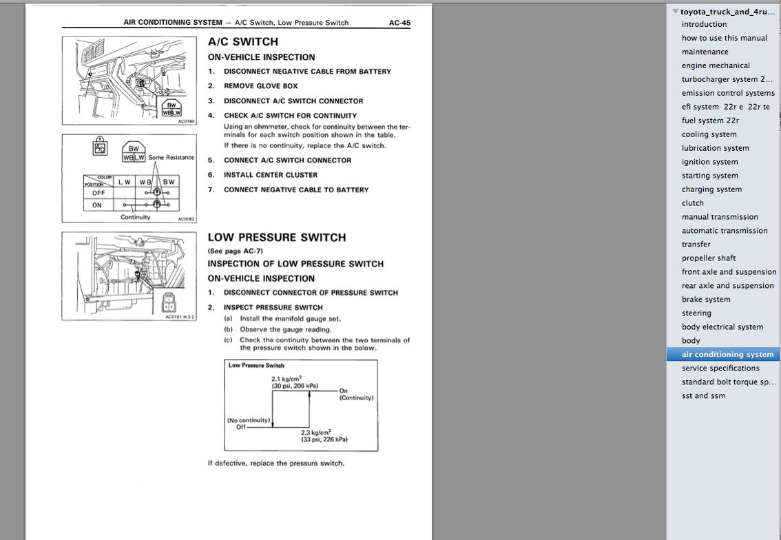

Does it blow at all when it is in the heat position? Take a look at your switch to see if it is within specs.

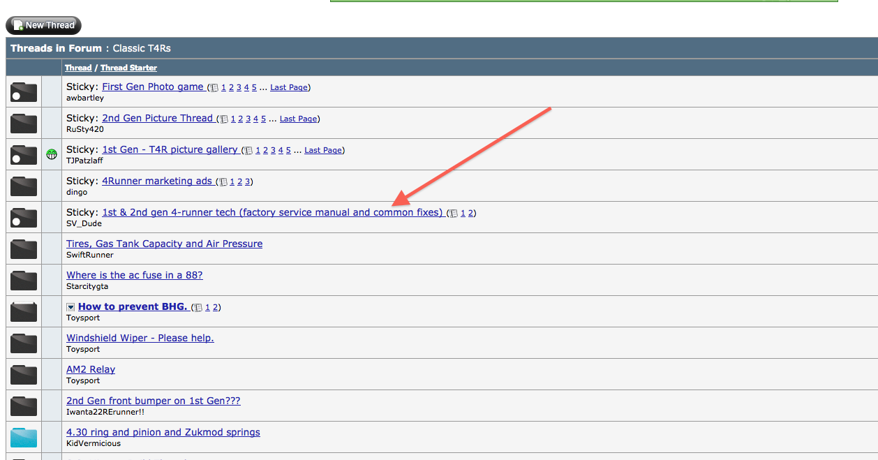

Pic below of the factory service manual is from the "Sticky" at the top of the "Classics" threads. It will have some other steps that you can run through.
