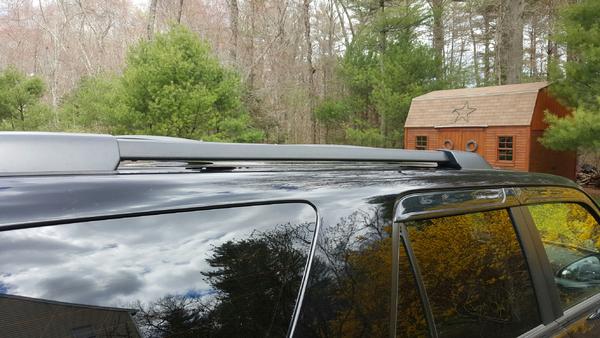

I used Rustoleum Bed Liner spray. Sprayed them in-situ. Only sprayed the sides and a bit around the top and bottom edge, the parts that show the most. Looks fine and was quick and easy. And bed liner is easy to touch up when they get dinged.
That looks good. My Yakima racks will mount right to it, but I'm thinking it may get scratched up easy. I may just need to add extra coats. I'm also exploring carbon fiber. I can do fiberglass work, but I am not sure how durable it will be since I will be clamping Yakimas right to it.
