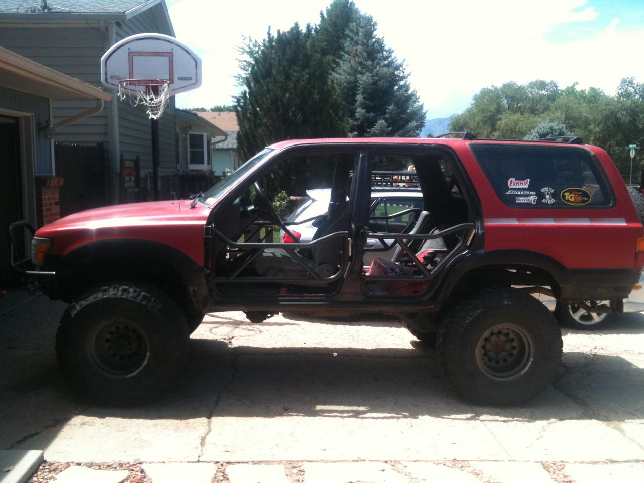

I run around 8" of total lift with my 36x15.5's and I love it because I can flex like crazy with all that room! Never really worry about tipping. Probably because my stance is so wide too cuz of the 4.25" of backspacing and 2" wheel spacers.
Hell, the brand new Tundra is taller than mine is stock, but I can sit indian style underneath mine without my head touching. Ground clearance is wonderfull.
Your tires look really small for 35's
I think 4runnertanks other 2inches of lift are coming from the tires.

In my head 5+1 is 6".. How are you getting 8"?
HAHA well I left out the fact that I have an add-a-leaf in the back and the t-bars cranked in the front, mainly because I DO NOT recommend doing so. It rides like a wooden buggy.
